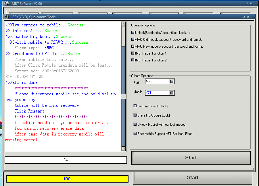

procedure
open mrt software
click vivo qc
click vivo new model
choose model
then

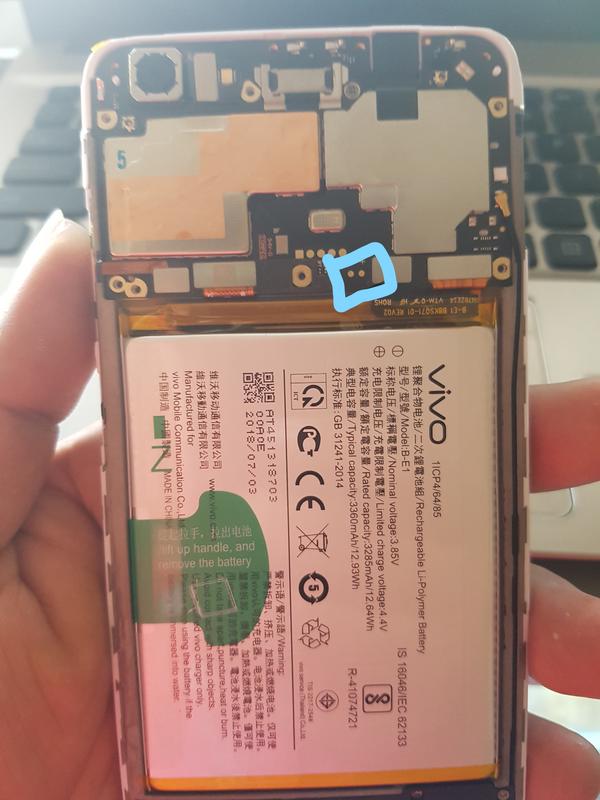

baklas muna likod ni vivo
gamit tweezer
short edl test point
insert usb
install driver then click start
wait until done
note pag matagal mabuhay
hang on logo
enter recovery then restore factory/wipe data

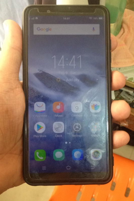

done done
