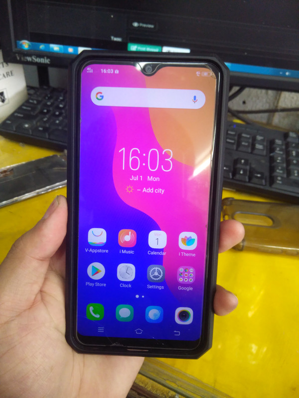

Vivo Y81 Passcode problem
Wala napo paligoy ligoy pa

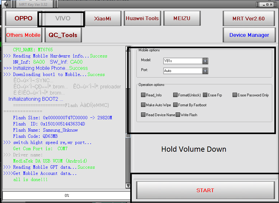

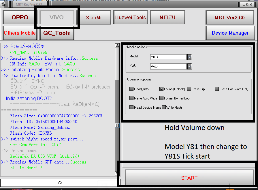

Open kagad mrt v3.33
tapos vivo
hanapit Y81S
Off Unit
Tick Start
Hold Volume Down then input USB Chord. wait until Done

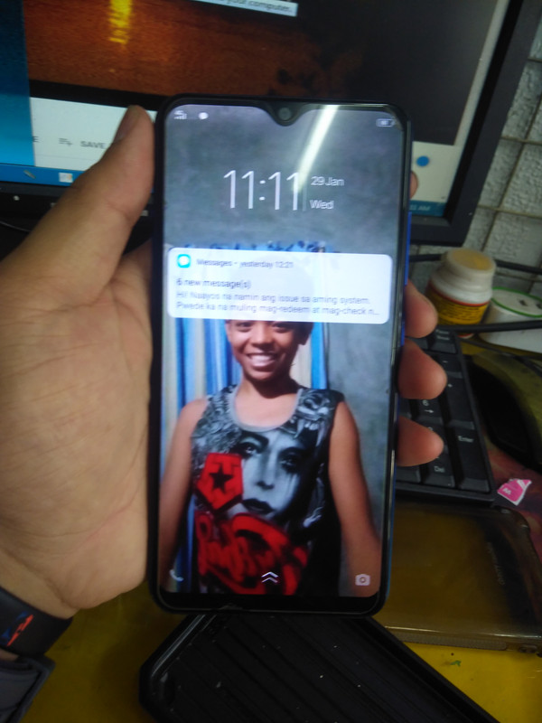

wow galing naman. chicken nalang sa eb.
100% yan tested many times at vivo Y15 pasok din sa Y83 at Y81s frp at mi account power off the phone select y83 or y81s click start and insert usb
