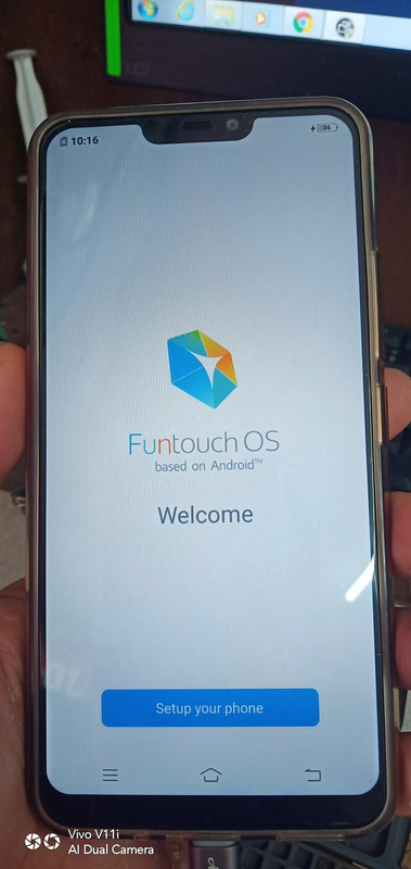

problem: passcode/frp
pasok ka xa recovery hold volume up power..
Choose Recovery Mode....
Choose Advanced Options....
Choose Reboot With ADB....

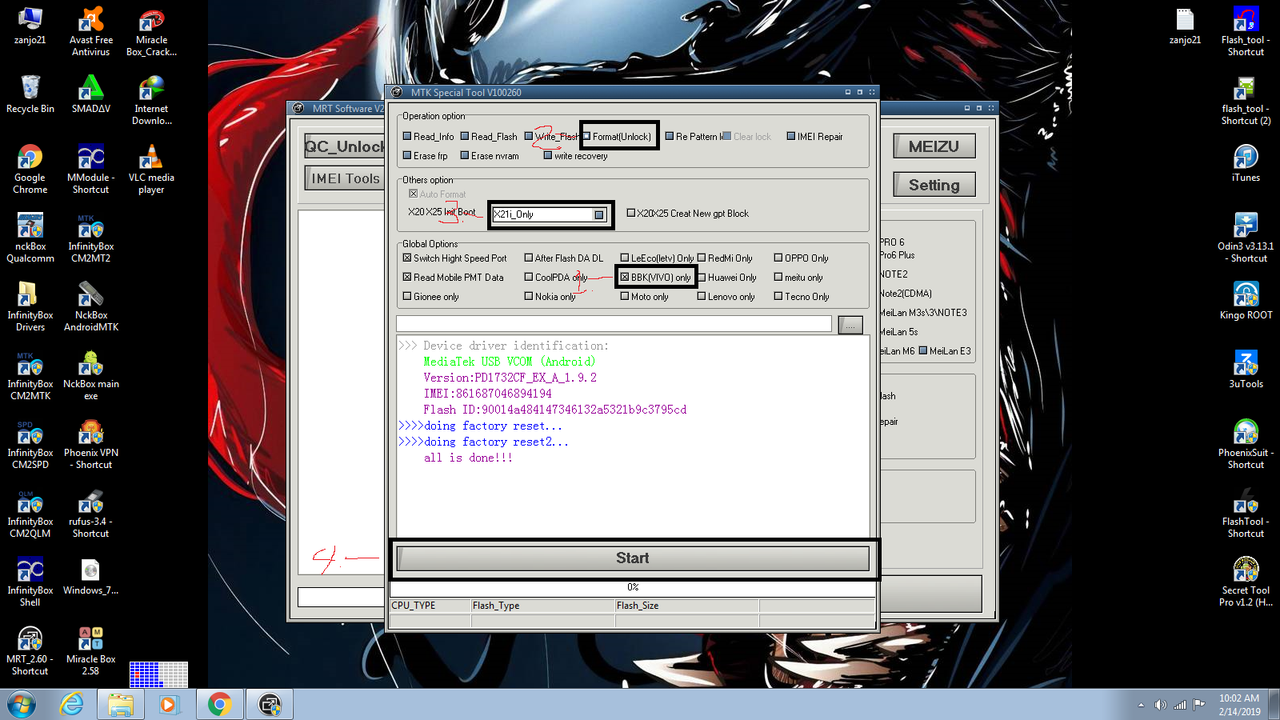

habang nagrerebboot z vivo... open mrt 2.60
pakisundan z pics...salpak usb and hit START!
sapul yan kung good ang drivers mo ni adb....

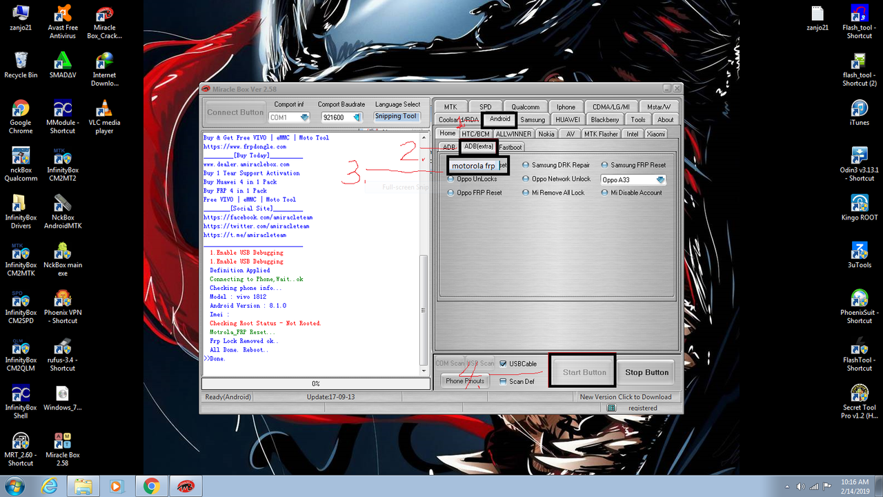

FRP naman...same process...
habang nagrreboot ule z vivo open mo nmn z miracle 2.58
pakisundan ule ung pics.....salpak usb and hit START!
BOOM AUTOMATIC NA YAN wla ng FRP......

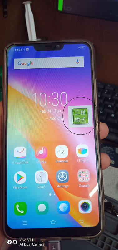

meron yang engineering mode ung intsik na BOX
HOLD mo lng pra maioff mo then restart mo ule DONE
