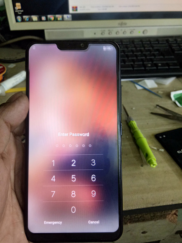

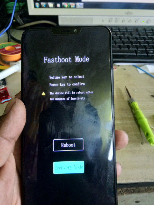

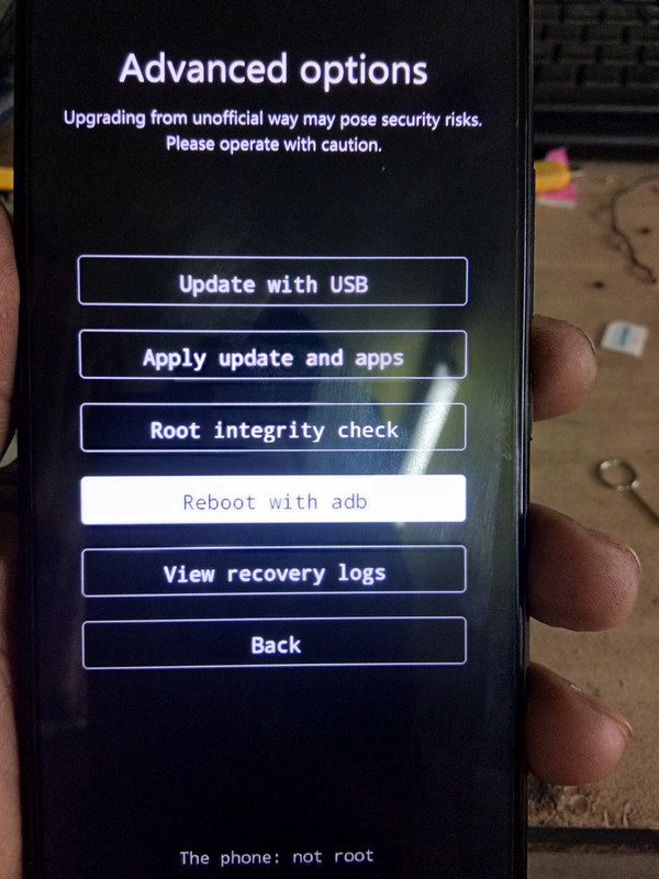

VIVO Y81i 1812 PASSWORD&FRP DONE

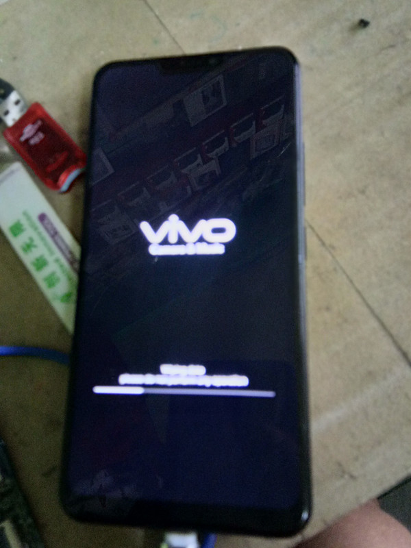

step 1..press VOL+&POWER BUTTON at PAPUNTAHIN SA "REBOOT WITH ADB"
PAG REBOOT NA SA ADB SALPAK SA PC

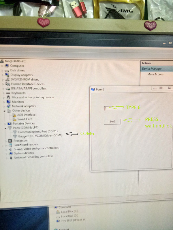

tingnan COM# at ITYPE ITO SA TOOLS THEN PRESS BUTTON on tools

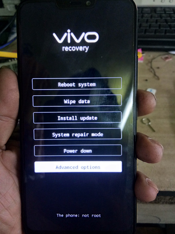

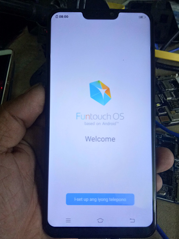

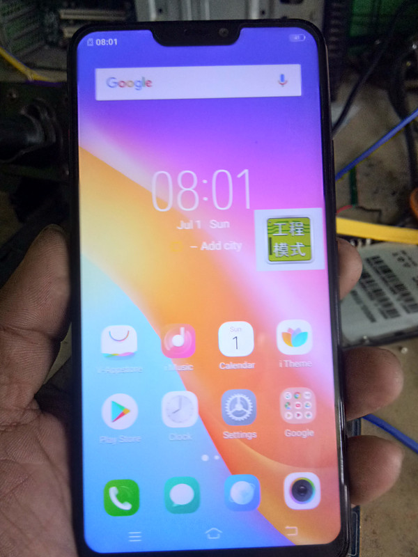

DONE
DONE with FEELINGS:D
