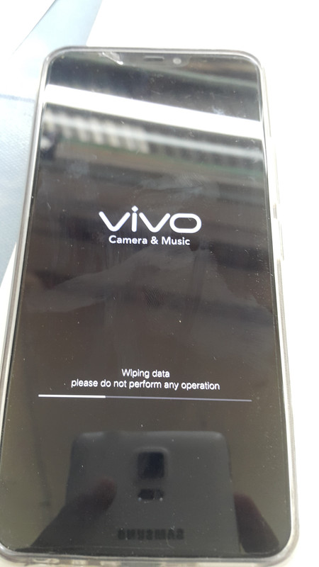

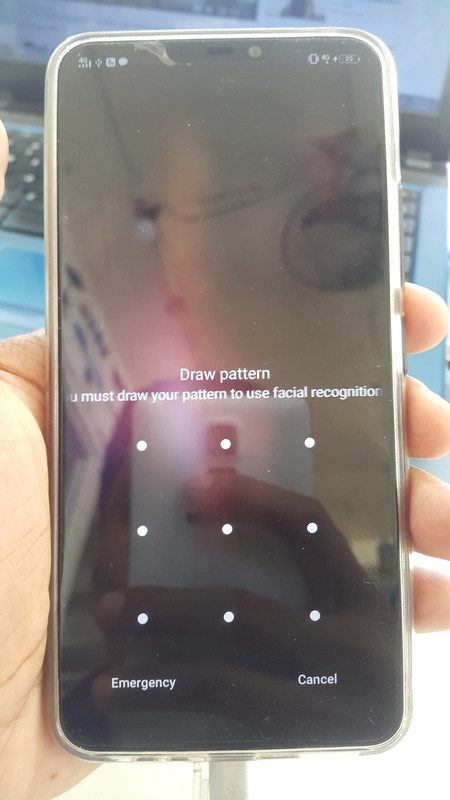

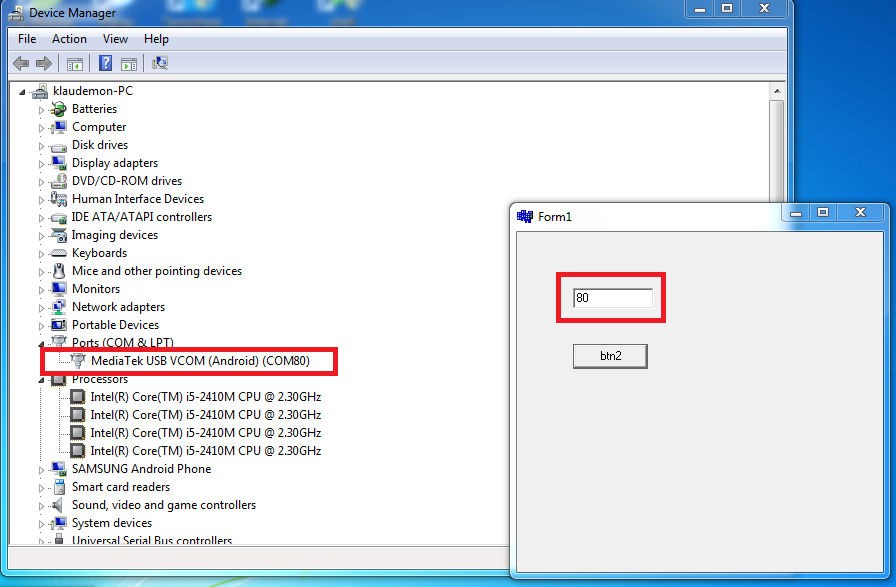

Please follow images below:

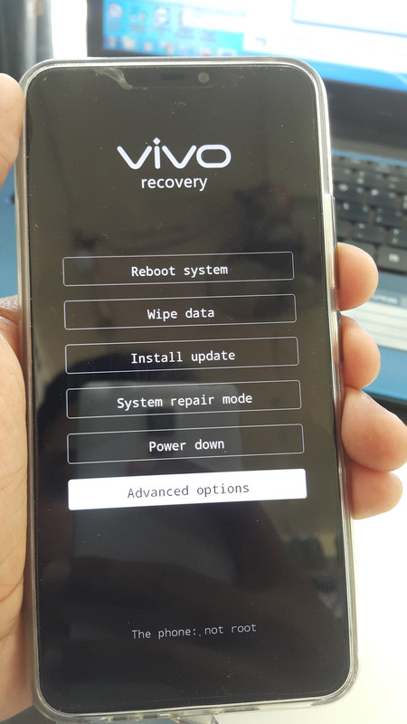

First: Click Volume Up + Power Button to go to "Recovery Mode"..
Then "Advanced Options"..

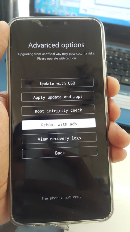

Next "Reboot with Adb"..

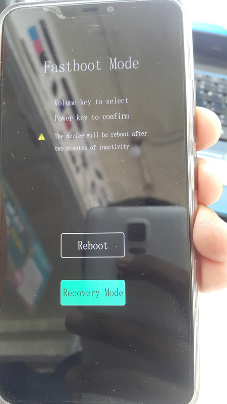

Salpak USB until detect na sya.. install driver (link below) kung wala pa at kelangan irestart ang PC.. after restart open tools at "Device Manager" para malaman kung anong COM# sya..
then input COM# sa form1 dapat parehas sa # na nadetect ng pc nyo..
click the button until finish.. seconds lang yan..

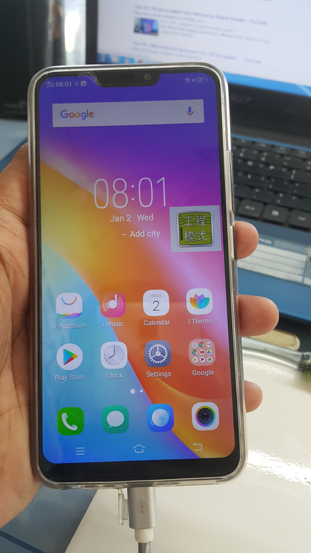

pag finish na click "OK" at hintayin lang na magrestart.. wag galawin ang phone..
Finish..
