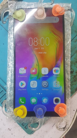

Vivo Y83 password and FRP bypass Via TFT MTK v3.5
procedure:
open TfT MTK module V3.5
click unlock operation
click vivo and model vivo y83
click factory reset+frp format
then click start..
hold volume + and -
insert cable...
wait until finish
then done.....
