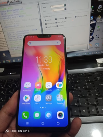

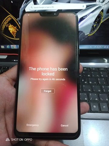

share ko lang po for reference...
Unit: Vivo Y85 1726.
Problem: pasword and frp.
ito ginawa ko for password.
1. Open mrt 3.33 ang gamit ko.
go to Vivo tab,
select model Y83
select Format unlock
then click Start.

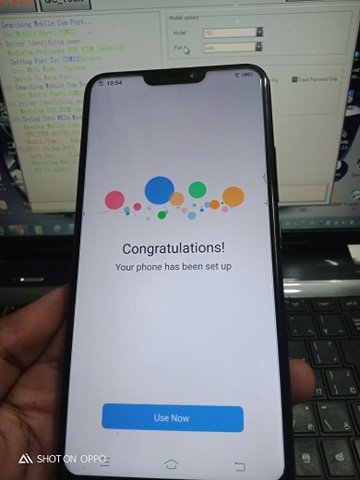

2. Salpak usb chord sa phone na nka on ang unit,connect to pc
tapos power off para ma detect ni pc in metamode.
ito result.

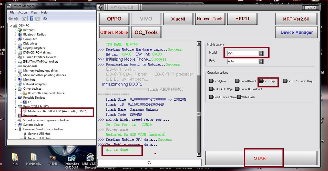

ito naman for FRP.
1. in Vivo tab.
Select model: X21i
erase Frp then click start.
2. para ma detect sa pc.
put the phone in recovery mode.
hold vol. up + power button
go to advance and reboot in adb.
after reboot, power off unit na nka connect na sa pc at ma dedetect na cya.
ito proof.
