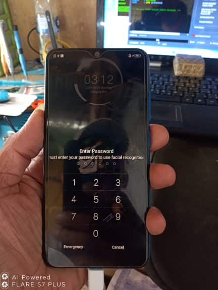

Device : Vivo Y91
Operation : Vivo Format FS / FRP Reset

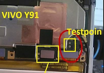

Turn Off phone, hold Vol UP + Vol DOWN and insert USB cable.
Some phones may need Special Boot Cable or TestPoint for EDL mode.

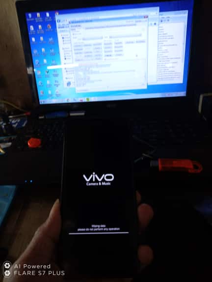

Formatting userdata...Done

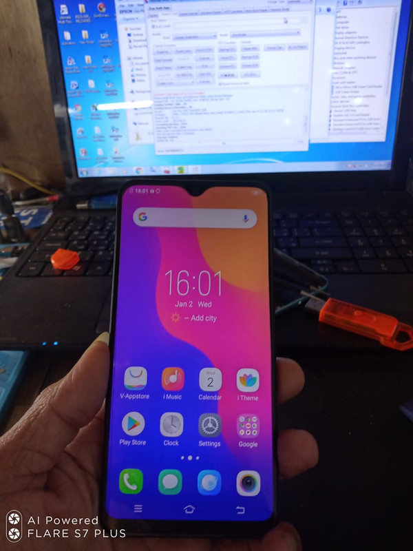

Resetting FRP Lock...Done
Wipe cache / userdata from Recovery and reboot.
First startup may take 2-5 minutes.
Operation Finished.
