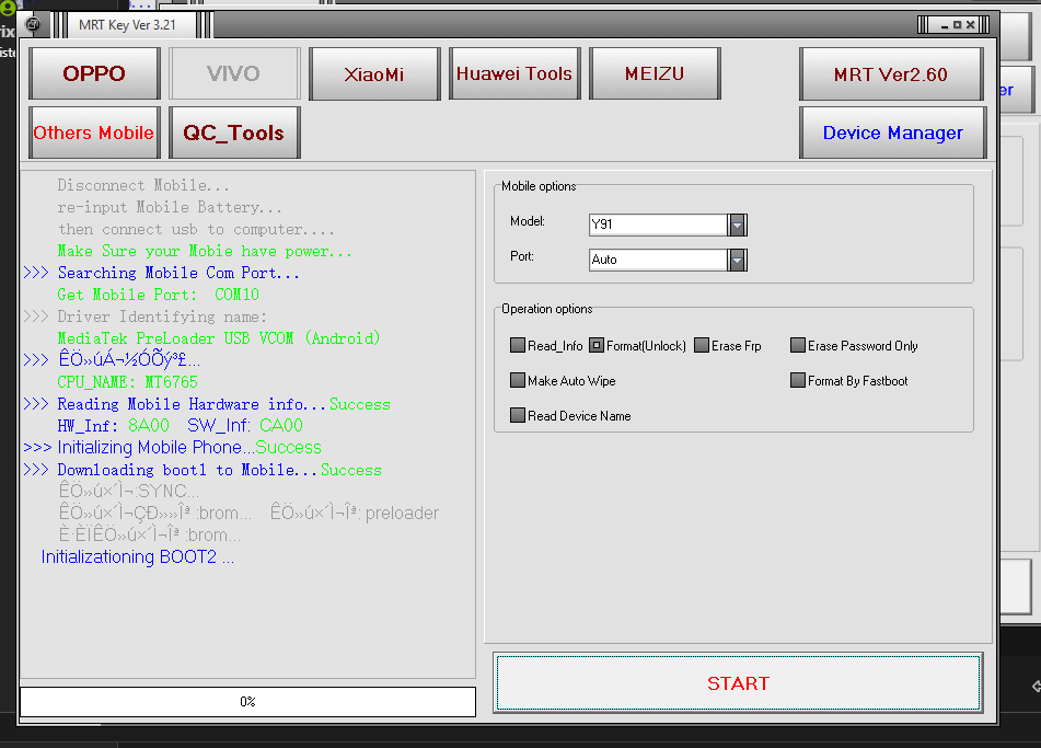

Vivo Y91 1820 pattern
first vol up and vol down para madectect ang driver tapos open mrt tools go to vivo select y91 select format (unlock) then press start...Frp: go to erase frp then press start...
Done na po mga kaantgsm...thank you and god bless...
boss, hanggan jan lang sya nag bbeep, nka encounter kaba nang ganyan?
Try mo boss huwag na pindutin ang vol up at vol down, kng hindi pa rin try mo ang latest version ng mrt set up tapos install driver.
