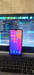

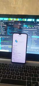

Vivo y91 frp remove via hydra qualcom tool.
Step:
Baklas si unit prepare for test point
Eject battery
Open hydra qualcom tool
Select:
Brand: vivo
Model: y91(V1818c)
Click vivo
Select
Factory reset protection(FRP) Demo remove
Click forced erase
Click execute
Tp unit
Plug USB cable
Kpag nag run na romeve tp
And wait until done
