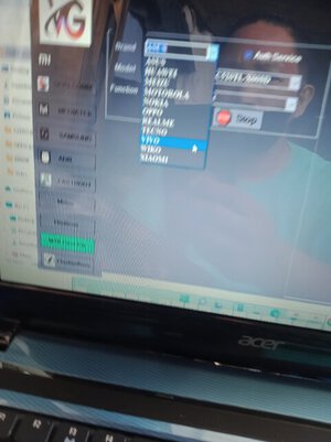

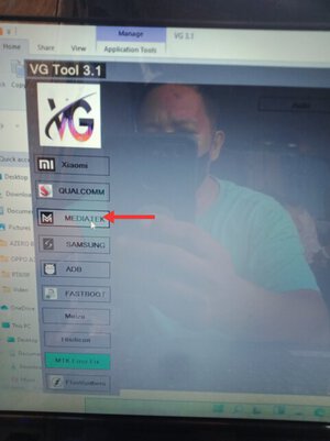

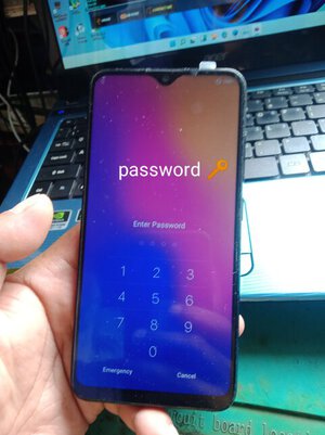

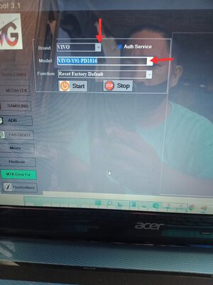

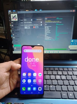

Share kolang gawa ko vivo y91 password problem.
Open VG Tool 3.1
Click - mediatek
Click -by model
Click- vivo
Click - model. Vivo y91 pd1816
Kaylangan naka off yong phone
Long pres volume up down.
Open VG Tool 3.1
Click - mediatek
Click -by model
Click- vivo
Meron latest version nito v3.3 with Schematic na kaasama but its a paid tool mga boss;
