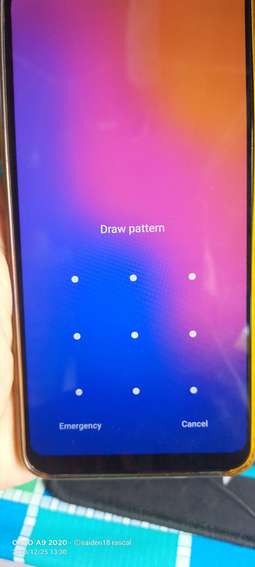

PROCEDURE
CLICK MRT.3.67
CLICK/ ON VIVO TAB/
SELECT VIVO Y91C/

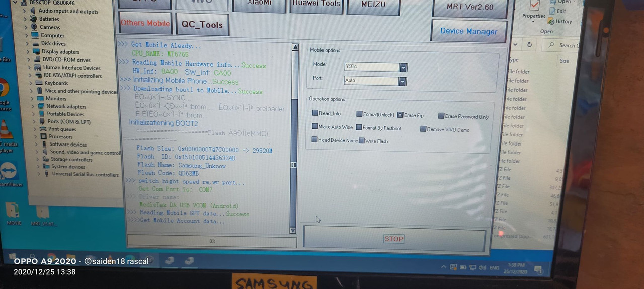

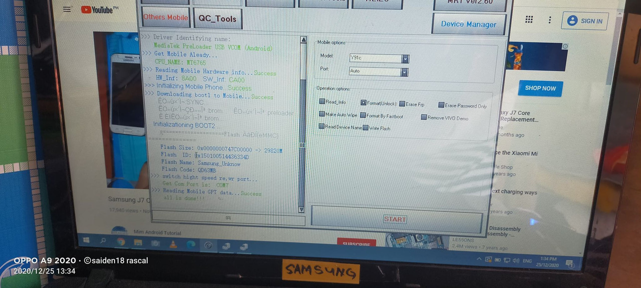

SELECT FORMAT UNLOCK
THEN HOLD VOLUME UP
THEN INSERT CABLE
CLICK START
WAITING DONE

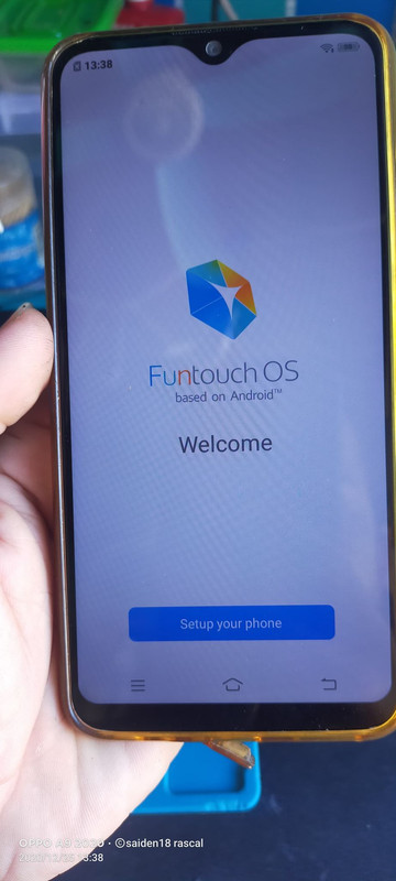

THEN SAME PROCEDURE
SA FRP CLICK FRP REMOVE WAITING ULIT
