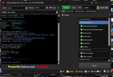

So nag try ako sa Meta Mode
To enter Metamode
Service Tab --- Tool --- Reboot --- Power Off Status / Metamode Auto
Execute
Bootkey Vol + - , salpak usb. Pag nadetect release agad bootkey
Wait lang matapos

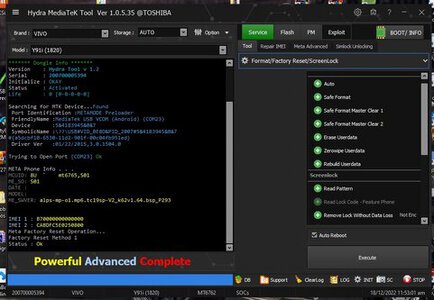

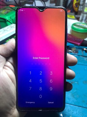

Para sa Password hayaan lang nakaconnect usb
Service Tab --- Tool --- Format/Factory Reset/Screen Lock
Metamode / Factory Reset Method 1 Old
Tick Auto Reboot
Execute
Wait lang po matapos at mag-boot phone

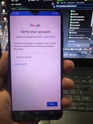

Set-up nyo phone pero wag muna i-connect sa wifi
Next next lang hanggang dun sa FACE and PASSWORD, click settings
Tapos mag-add ng password or pattern
Set Security Questions
Done --- OK
Cancel na lang po sa Facial Recognition

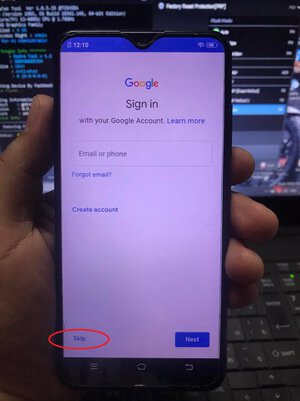

Back back at connect sa Wifi
Next Next lang at gamitin ang password na ginawa
Mapapansin na nagkaroon ng SKIP sa google log-in
Skip skip lang at ok na
