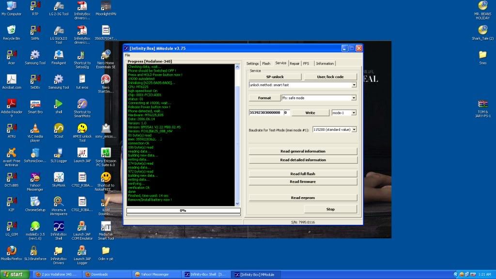

mga bossing share ko lang vodafone 340 smoothly unlock
by infinity.
tools neede
infinity box
cable x series lg gb190.
open infintity shell select vodafone 340
just tick sp unlock wait till done.
logs.
M33 [VCP0] selected
module v3.75
Action: "sp-unlock"
unlock method: smart fast
Model: Vodafone-340
Checking data, wait...
Phone should be Switched OFF !
Press and HOLD Power button now !
19200 autodetect
Initializing [6225:8A05:8A00]...
CPU: MT6225
high speed boot On
chip: 0001:FC03:A001
status: 01
Connecting at 19200, wait...
Release Power button now !
Phone detected, wait...
Hardware: MT6225,E05
Date: 2006.06.14
Version: 1.0
Version: BM35A1.V2.22.M00.02.45
Version: FOXLINK25_08B_HW
81 byte(s) read
imei: 3559220362xxxx
connection Ok
186 byte(s) read
reading data...
building new data...
writing data...
174 byte(s) read
reading data...
972 byte(s) read
writing data...
verifying...
verification Ok
done
Finished, time used: 14 sec
Remove/Install battery now !
screenshot
