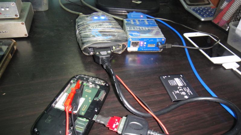

TOOLS:
1. s -card
2. Gpg dragon for interface

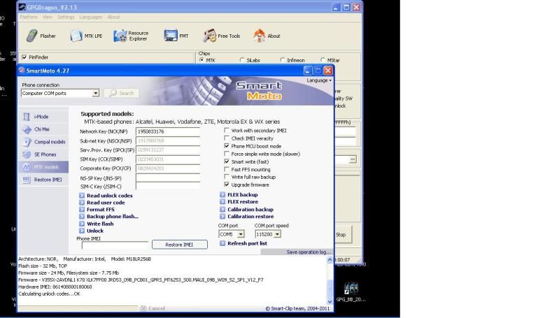

Procedure:
1. Run GPGdragon and Detect phone (select MTK)
2. Run Smartmoto and select computer comports
3. Select MTK models
4. Select Desired port (base on your dragon comport)
5. select Read Codes for safety

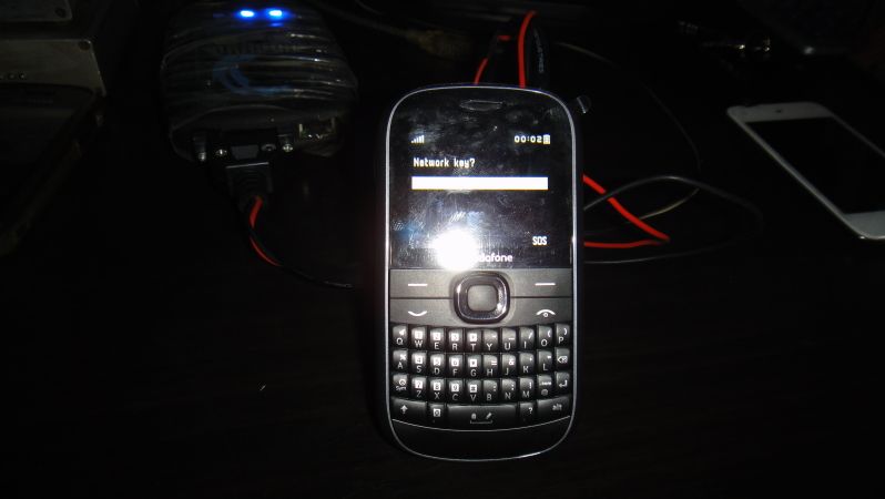

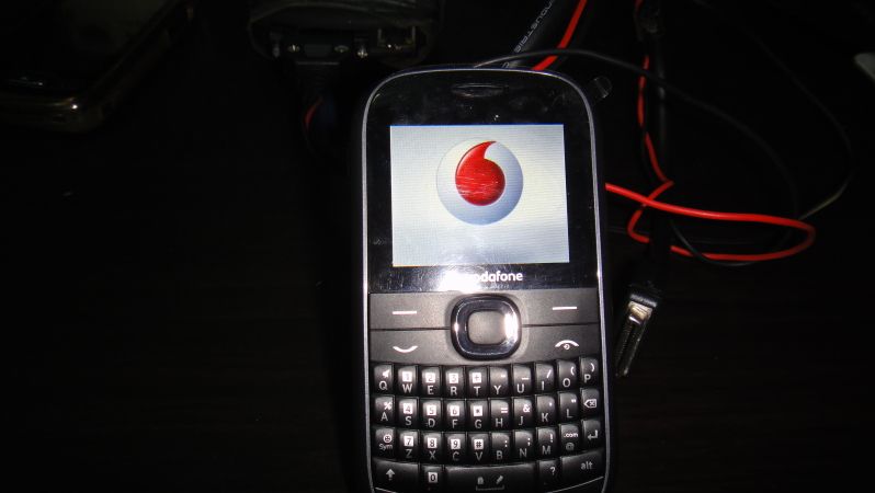

6. Insert non-accepted sim
7. Enter readed codes
SmartMoto 4.27
S-Card: 222938265 Smart-Clip dongle, v 3.10, assigned Smart-Clip: 983668943 Europe, initializing... OK
Prolific USB-to-Serial Comm Port (COM5), provider - Prolific, drv. ver. 2.0.0.26 from 6/24/2004
MCU: MT6253, HW rev. A.04, SW rev. A.00
Release the Power ON button
Testing external RAM...16 Mb
Architecture: NOR, Manufacturer: Intel, Model: M18LR256B
Flash size - 32 Mb, TOP
Firmware size - 24 Mb, Filesystem size - 7.75 Mb
Firmware - V355X-2AVDNL1 K70 XLK7FF00 JRD53_09B_PCB01_GPRS_MT6253_S00.MAUI_09B_W09_52_SP 1_V12_F7
Hardware IMEI: 861408000180060
Calculating unlock codes...OK
