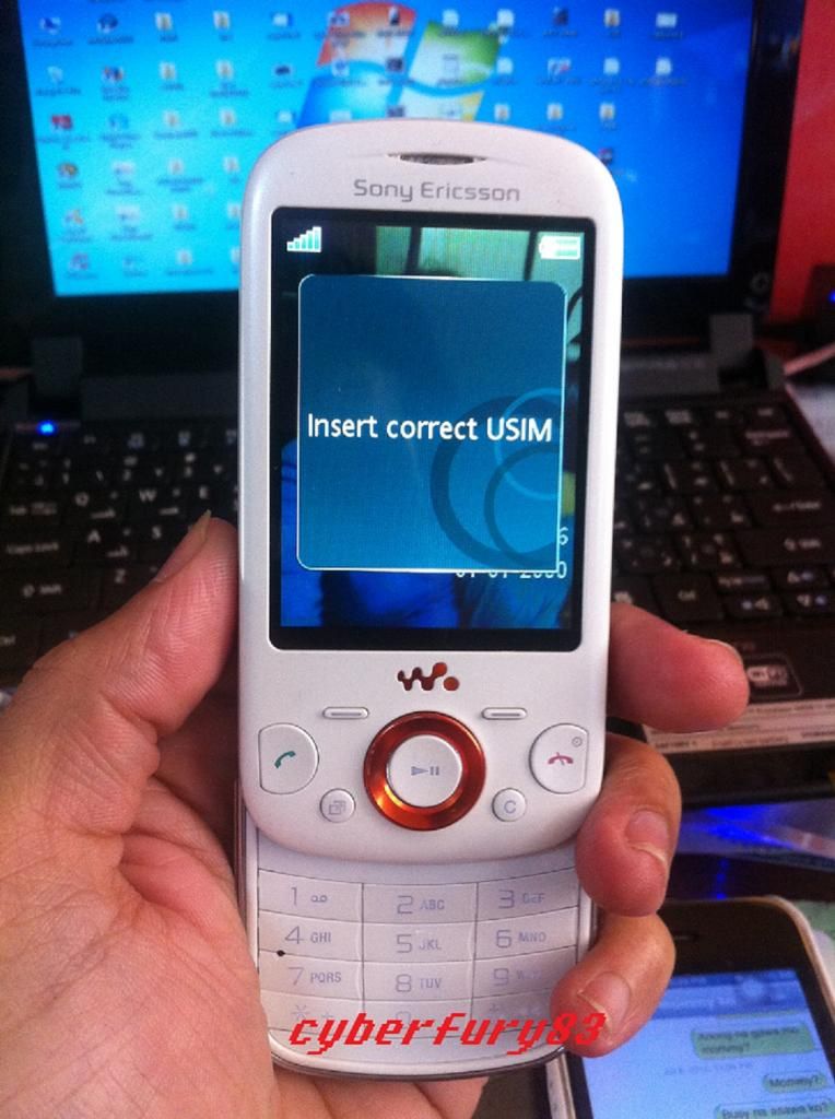

PROBLEM
NETWORK LOCK (3 NETWORK)

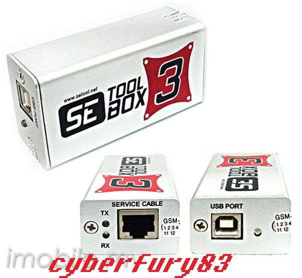

S.E. TOOL

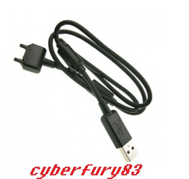

DCU-60 CABLE
3 credits

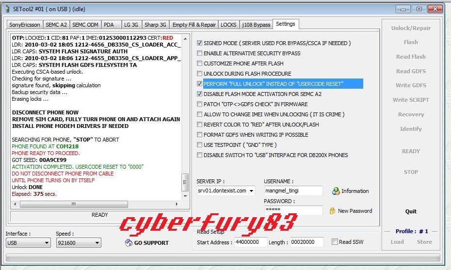

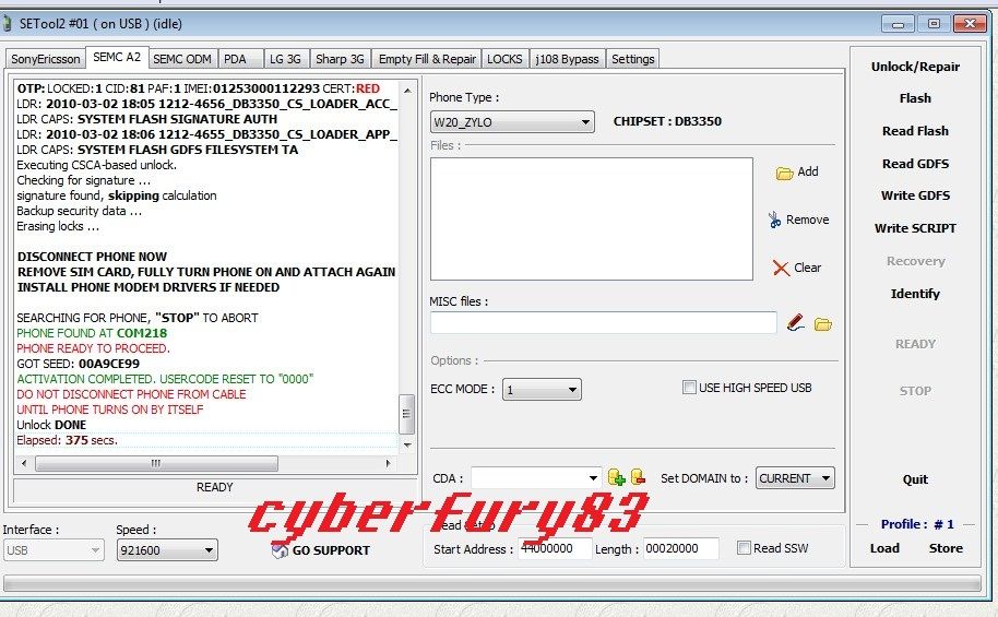

OPEN S.E. TOOL SOFTWARE
CLICK SEMC A2 TAB
SELECT CORRECT MODEL
CLICK SETTINGS TAB
CHECK SIGNED MODE
CHECK PERFORM FULL UNLOCK INSTEAD OF USERCODE RESET
CHECK DISABLED FLASH MODE ACTIVATION SEMC A2
TYPE THE USERNAME & PASSWORD TO THE DIALOG BOX IN THE BOTTOM
CLICK UNLOCK/REAPIR
AND FOLLOW THE NEXT PROCEDURE GIVEN BY THE SOFTWARE
DONE!!!
HERE'S THE SCREEN SHOOT

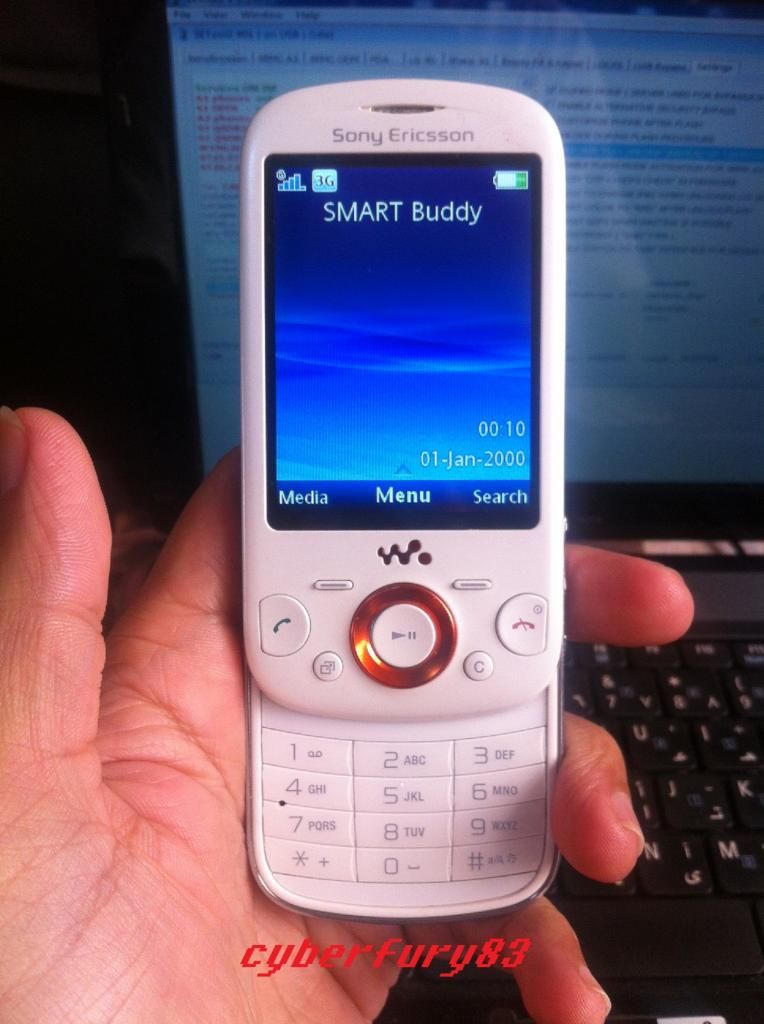

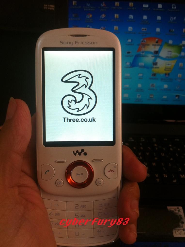

HERE'S THE PICTURE
