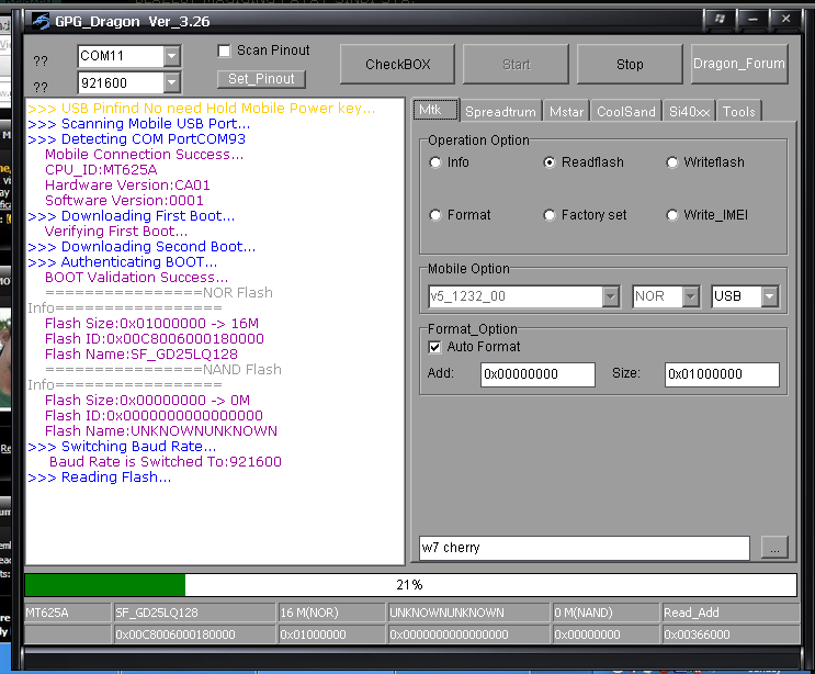

w7 pattern lock {gpg_v26}done....[Reference]
w7 nakalimtan ng meari ang screenlock
1st thing we do..
DL; gpg_v3.26: http://uploadmb.com/dw.php?id=1376121382&/DRAGON
din.. http://uploadmb.com/dw.php?id=1376122069&/MTK para sa usb mtk device driver
install mna si mtk driver,pagkatapos extract mo si gpg_3.26 sa gusto mu na distination folder
OPen gpg icons at simulan na:
sakin ... ito po patunay:

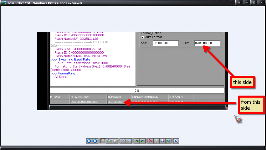

pagkatpos nyo ma info and read flash i edit nyo lang po ito: bago nyo po i format
iwas... patay sendi po..

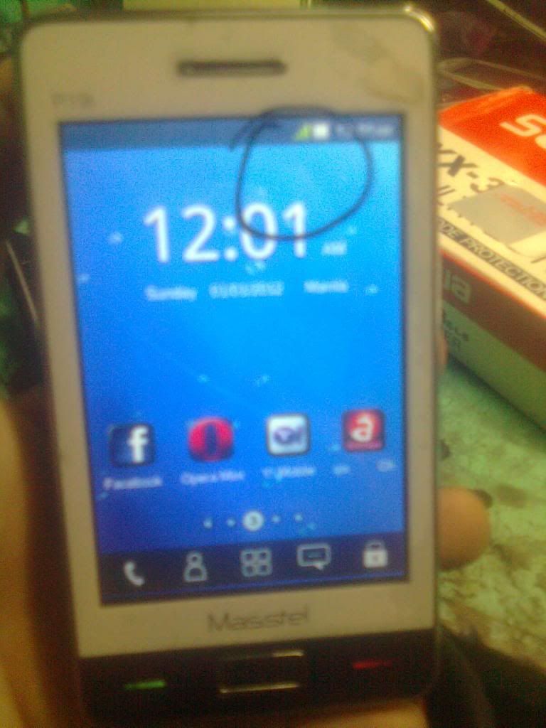

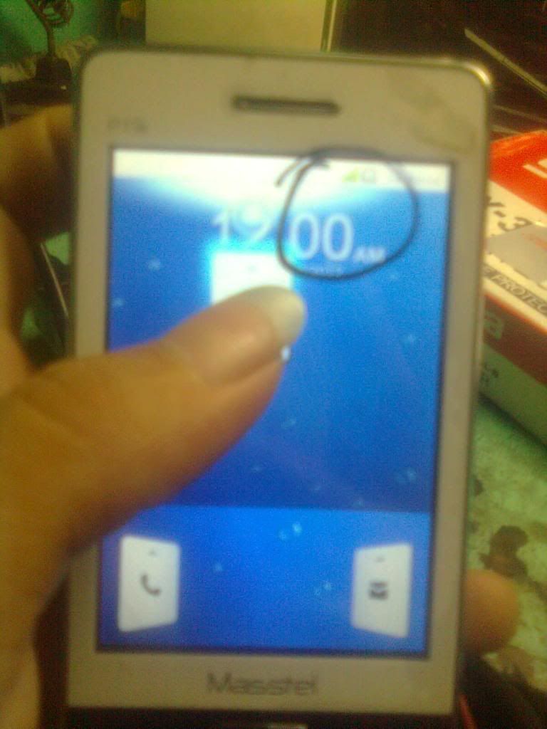

testing:
