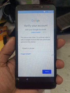

Blessed day mga ka Ants share ko lng tong tanggap ko frp wiko sabi ni tomer nereset nya at d alam gmail account
Sana makatulong sa inyo salamat po Godbless at all
History frp
Solution
1try ko manual pero no lock kc update yt

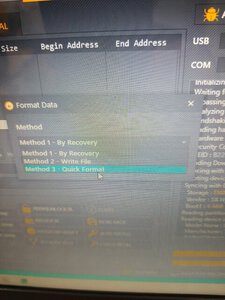

2.naisip ko try ko kya sa ut total mtk naman
Ito ung gnwa ko

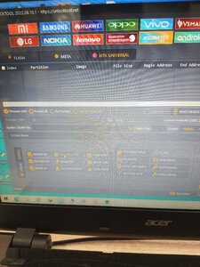

Open ut
Select mtk
Select generic

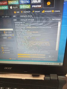

Select format data
Select method3 quick format click select
Hold volkey saksak usb wait until finish
