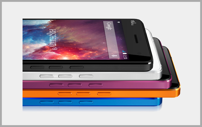

Flash Android Stock ROM for Wiko Highway and Wiko Cink Slim 2 using Smart Phone Flash Tool:
This guide works only with the two listed Wiko models.
All the remaining devices can have the stock ROM installed like this: download their zip files from the Devices panel, extract the contents in the zip.
Run the extracted Stock ROM executable and then follow the instructions listed by the application.
For the Wiko Highway and Cink Slim 2 you should follow the info below:
