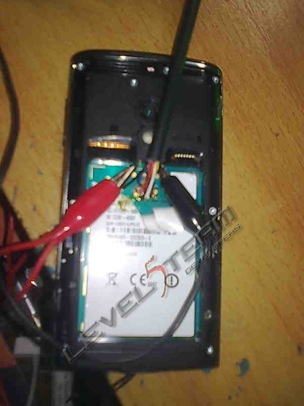

Kausap muna customer na kaya eh unlock ang unit un nga lang need baklasin ang sticker
so payag naman ang customer basta magamit daw..
tip..pag baklas ng sticker initan ng hot air wag masyado ma init mild lang
para lalambot ang sticker sabay dahan2x pag baklas

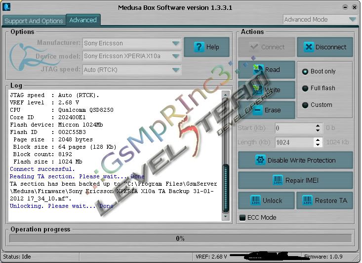

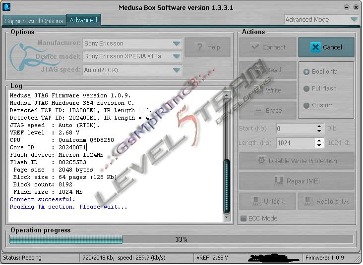

*Procedure
1. connect jtag pinout properly lagyan ng supply gamit ko R.P.S

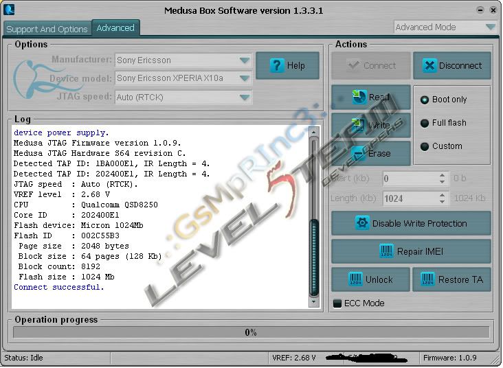

2. open medusa software
3. Select advance mode
4. Click connect

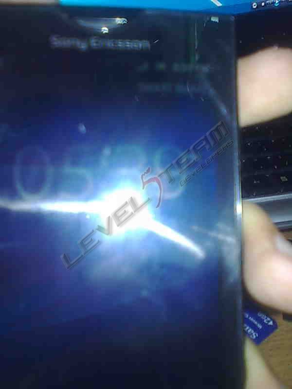

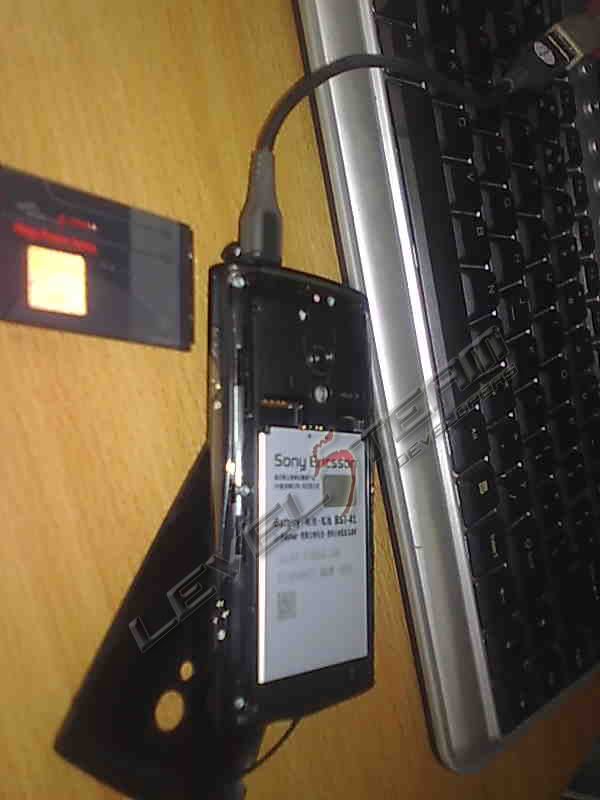

5. click unlock wait after few minutes you're phone is successfully unlock
Unlock Done
