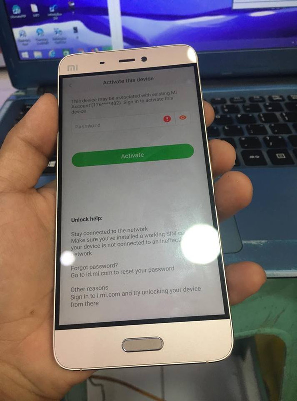

ISSUE NALIMUTAN DAW YUNG (MI ACCOUNT TSAKA YUNG GOOGLE ACCOUNT) HEHE

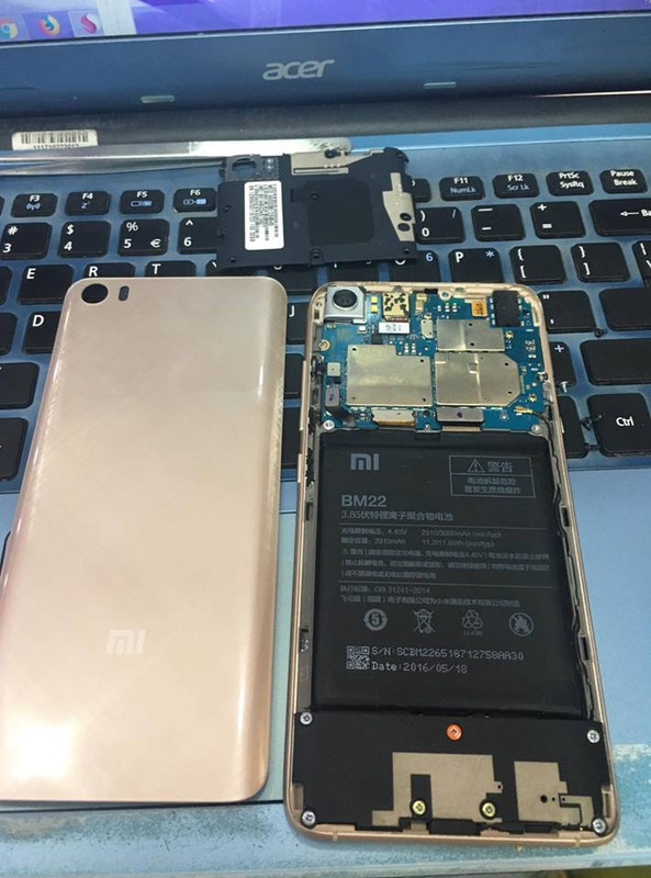

OFF MO MUNA YUNG PHONE TAS BAKLASIN MO NA KAHIT MASAKIT SA MATA HAHAHA LAKASAN MO LOOB MO.

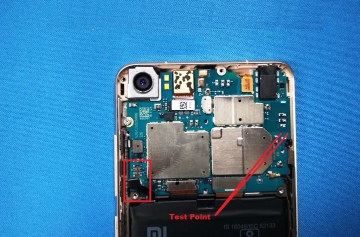

AYAN MGA MASTER/ ITO YUNG TESTPOINT NA PAGDIDIKITIN MO. AT SYEMPRE TANGGALIN MO RIN BATTERY.

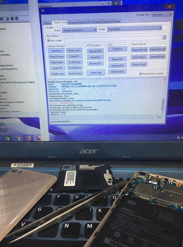

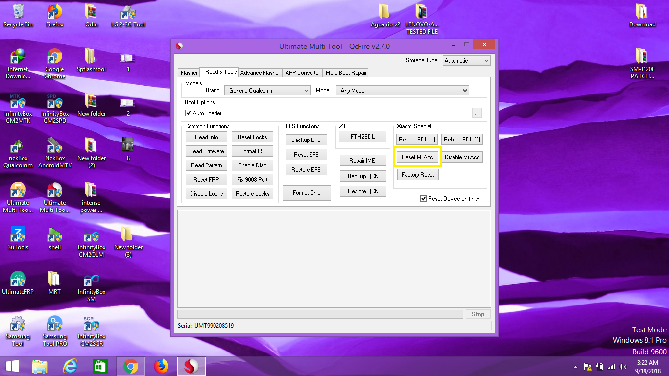

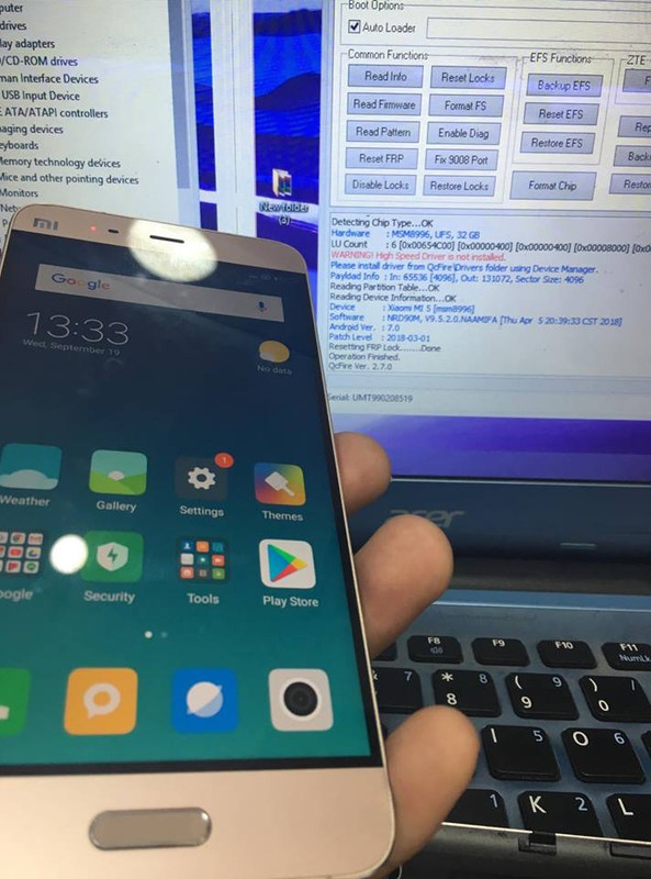

TAS OPEN MO NA SI UMT TAS PUNTA KA AGAD SA READ AND TOOLS LIKE THIS, TAS REKTA KA NANG (RESET MI ACC) TAS KUHA KANG TWISSER TAS TEST POINT MO WAG MONG TATANGGALIN TAS SAKSAK TAS MAGDE DETECT NAYAN HEHEHE <3

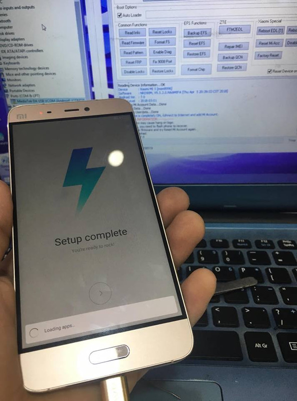

TAS DONE NAYAN MGA BOSSING MASTER IDOL GENTO OH.
TAS PAG MAY GOOGLE ACCOUNT GANUN LANG DIN PROCESS TAS RESET FRP LANG DONE NA HEHEHE <3
