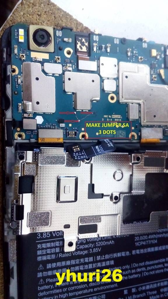

Step 1: Jumper muna sa 3 dots pagkatapos connect to pc without battery hintayin matapos mag-install ang driver

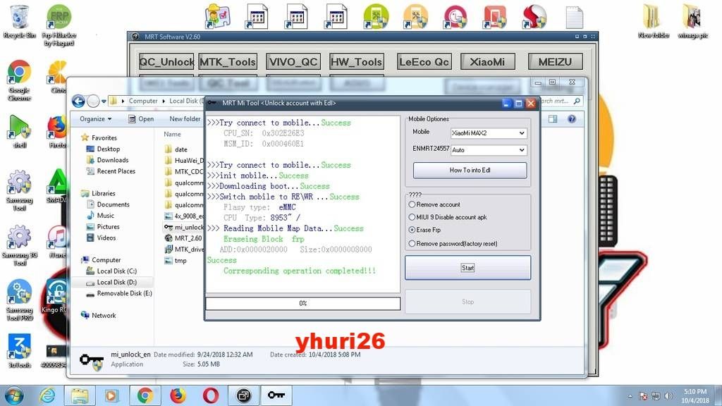

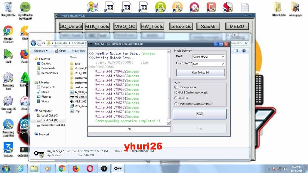

Step 2: Open mi_unlock_en piliin ang tamang model xiaomi max2 select remove account
Step 3: Select Erase Frp

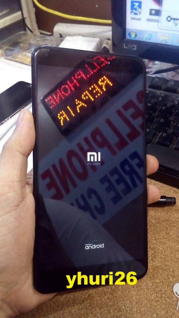

Finish product
