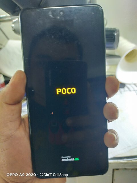

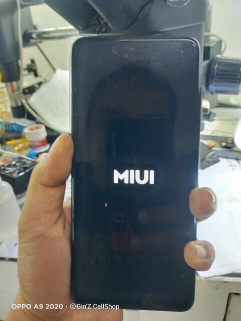

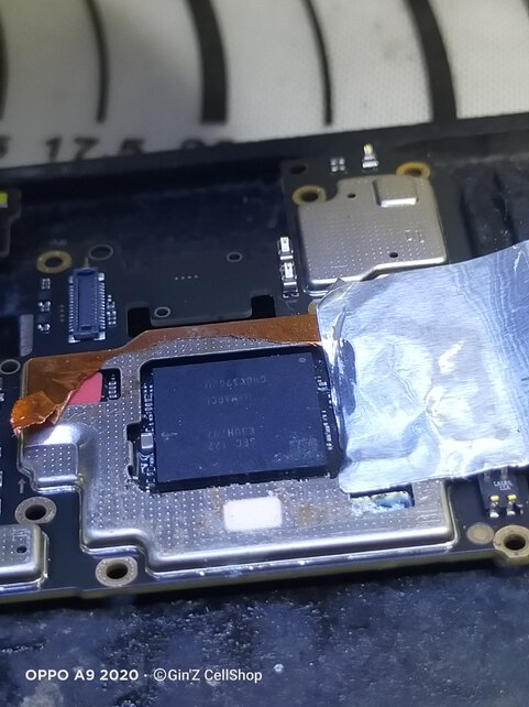

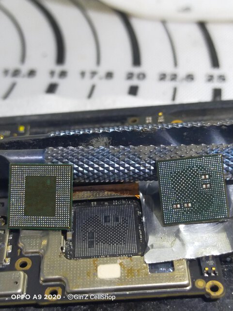

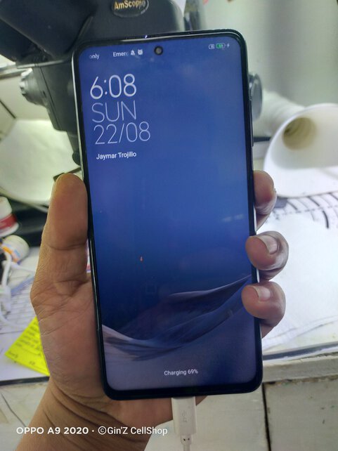

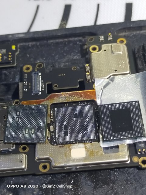

POCO X3 PRO NO POWER
ACTION TAKEN
1.) CHECK SA SCHEMATIC CHARGER, CURRENT READING 0.10mA then DROP TO 0
2.)DISASSEMBLE UNIT AT VISUAL CHECK, MALINIS NMAN VIRGIN PA WALANG GALAW
3.) PROCEED NA SA CPU AT RAM REWORK
HEAT AND AIR FOR CPU NAD RAM REMOVAL - 360° 60a
HEAT AND AIR FOR CPU AND RAM INSTALLATION - 380° 20a
REBALLING PASTE MID TEMP 158°
IMG20221220144700.jpgIMG20221220155643_BURST000_COVER.jpgIMG20221220161106.jpgIMG20221220170030.jpgIMG20221220170049.jpgIMG20221220170014.jpg
DONE!!! TESTED SOLUTION WITH LOW PERCENTAGE OF BACKJOB :cool:
