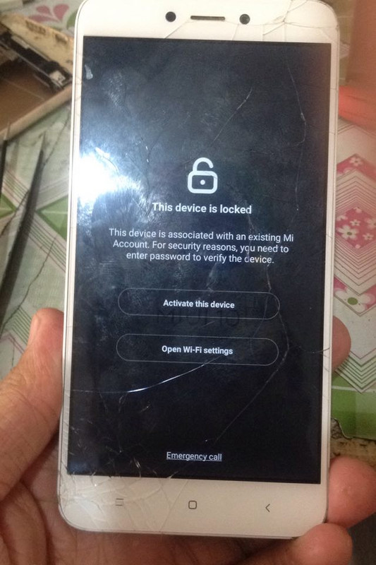

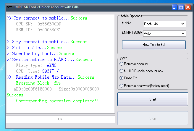

REDMI 4X
PROBLEM MI ACCOUNT
search ako dito sa tahanan
meron ako nakita kaso wala procedure (medyo nangangapa pa ko sa mrt eh)
kya punta kay pareng google
eto na

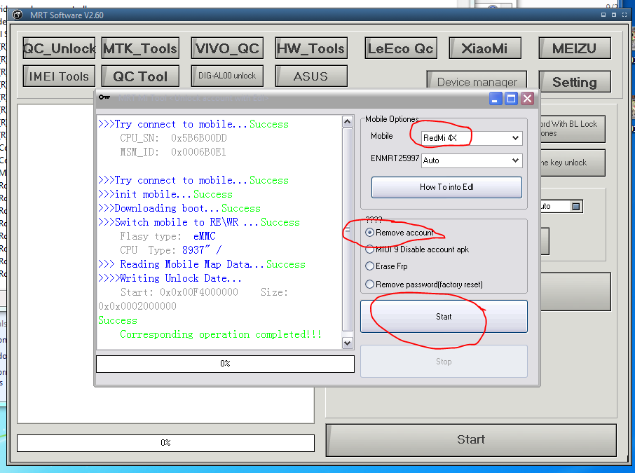

OPEN MRT TOOL
CHOOSE XIAOMI TAB
FOLLOW SCREENSHOTS

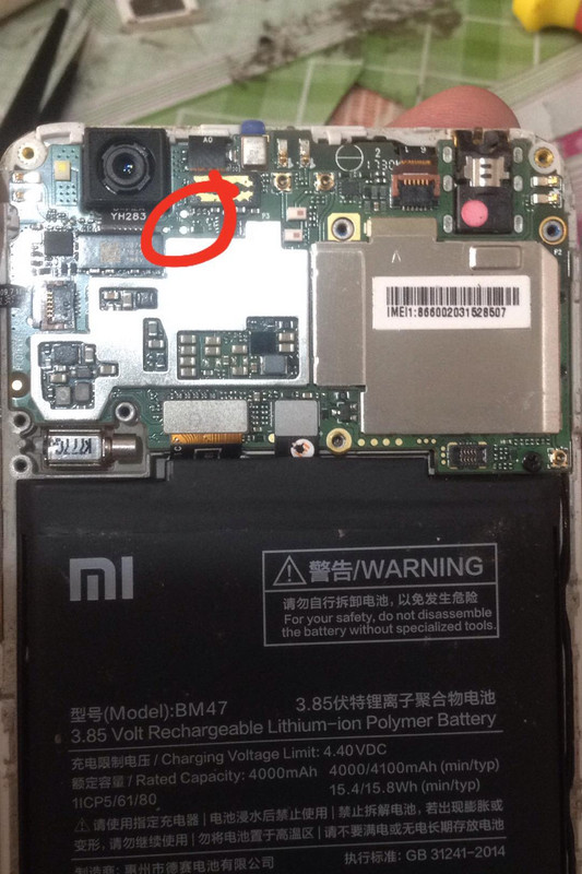

TEST POINT PARA MADETECT
REMOVE BATERY
then short yung test point
insert usb
install driver
choose model then start

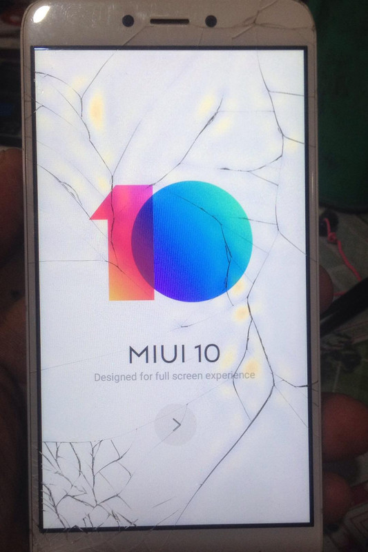

done na wala na account

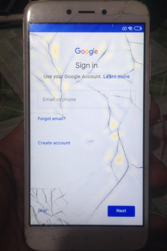

kaso may frp
balik tayu sa mrt
same procedure
tick erase frp

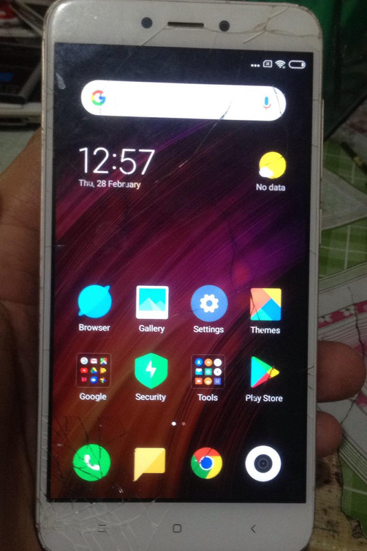

done done na
for reference
