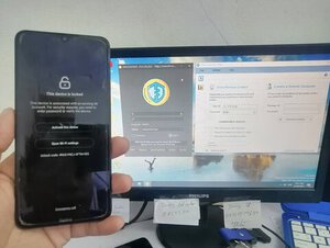

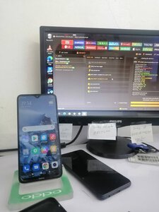

XIAOMI REDMI 8 mi account bypassed
run unlocktool
click security
search model xiaomi redmi 8 (olive)

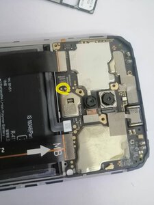

phone in offmode-battery disconnected, connect testpoint then connect usb cable to pc
AFTER detected in unlocktool
CLICK EDL
click RESET/RESET MI CLOUD
click (edl) reset mi cloud
wait till operation is finished
