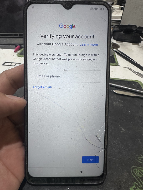

Hi
Unit: Xiaomi
Model: Redmi 9A ( M2006C3LG )
Problem: Gmail or Google account
Solution: Unlock Via Pandora box
Procedures
Logs:
images

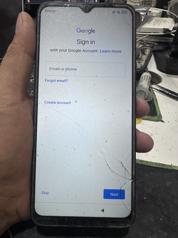

Unit: Xiaomi
Procedures
- Turn off Device
- Open pandora
- select Redmi 9A Dandelion
- Press and Hold Vol-up and Vol Down
- click Erase FRP
- Insert Cable
- Wait until Done
