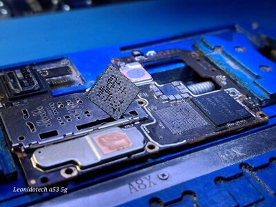

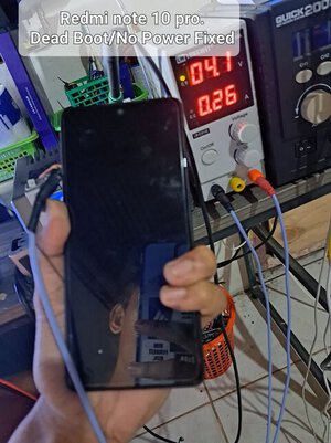

Problem: Xiaomi Redmi note 10 pro Dead boot/ No power
Visual Check
Full charge
Product Schematic reading 0.10
Longwei Power Supply 0.26 reading niya
No Pc Detect
Solution Reball Cpu
Tools Needed
-Quick 2008
-Mechanic Solder Paste
-Cpu SM7125 Amaoe Stencil
-Sexy Blade
-Amtech Flux
-To remove Cpu HEAT 380 AIR 60
-To put it back Cpu Heat 370 AIR 40
For Box Activation at Remote Services
