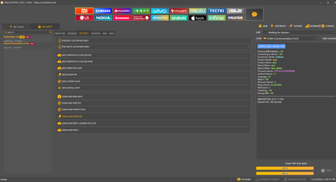

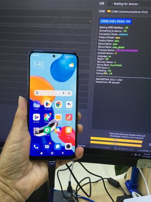

xiaomi redmi note 11 frp
run unlocktool latest version
select platform xiaomi
click security
select recovery
phone in off mode,. hold vol+ & power until goes to recovery then select connect with mi assistant
and connect usb cable to pc
click (sideload) erase frp
wait till operation completed
