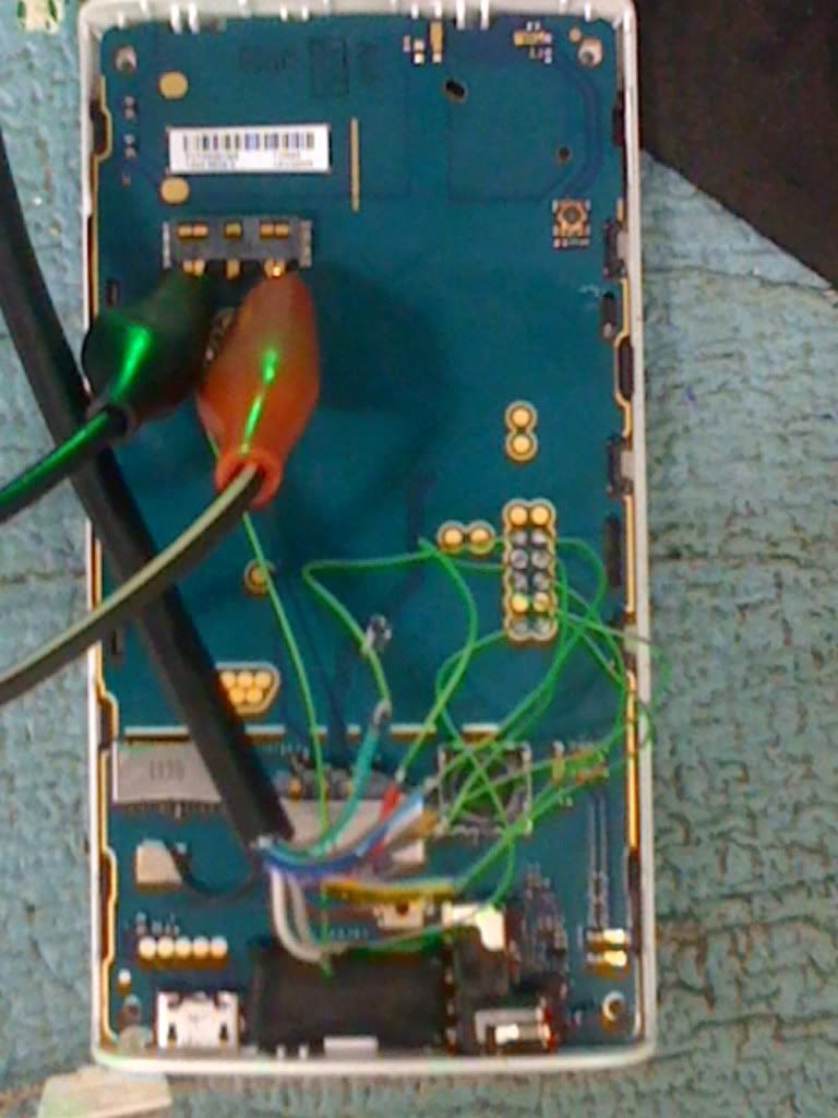

eto po konting screen shot's

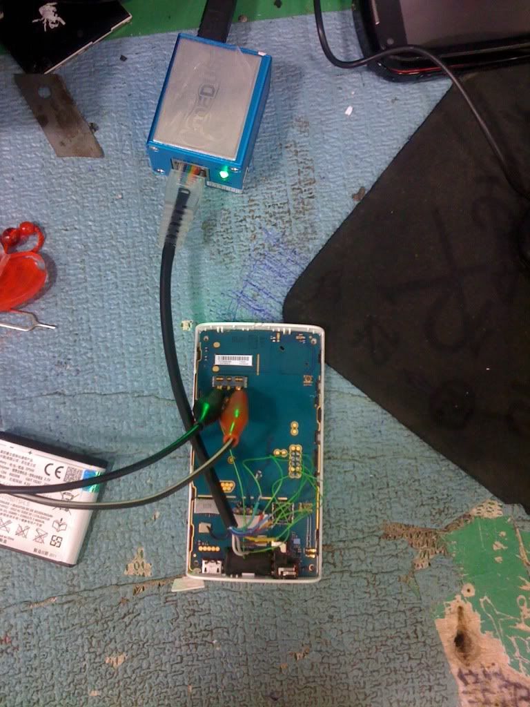

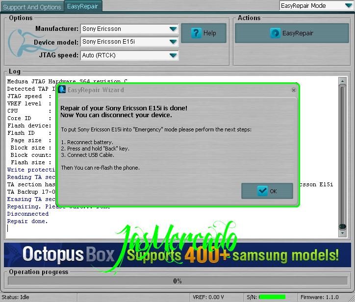

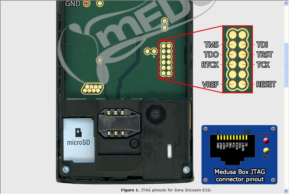

medusa jtag e15i pinout

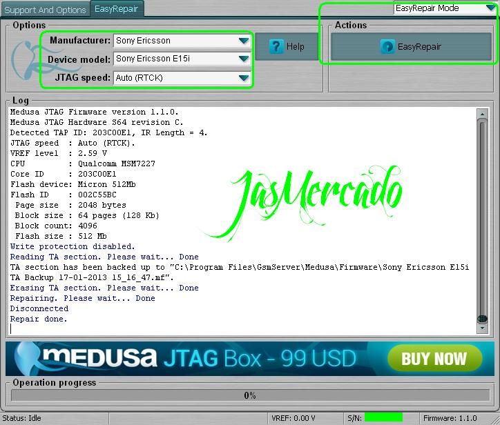

open medusa soft.
select sony ericsson
select correct model (E15i)
click easyrepair
download mf files
wait until repair done.

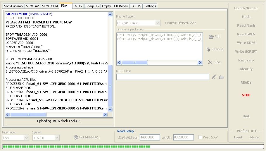

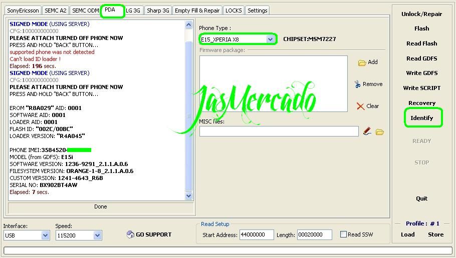

now proceed to flashing via SETOOL
open setool.gui
pda
phone type (E15_XPERIA_X8)

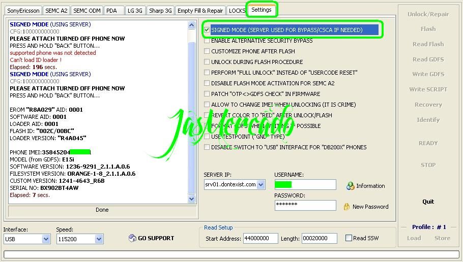

settings (check sign mode only)
click identify

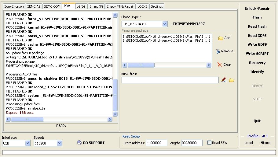

select flash file

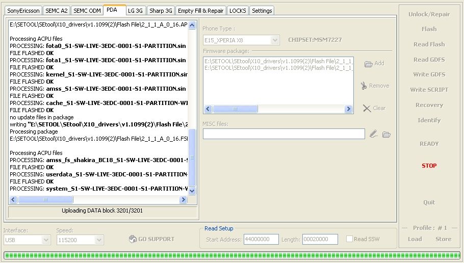

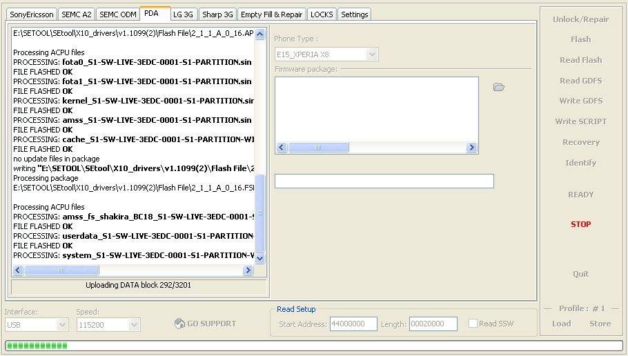

click flash
wait until DONE!!
screen shot's

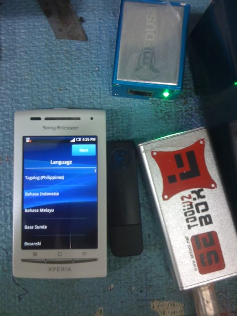

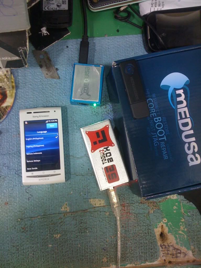

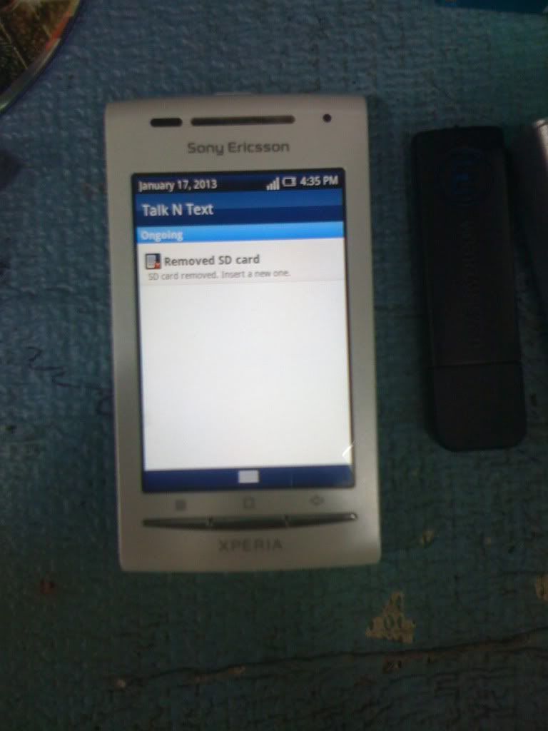

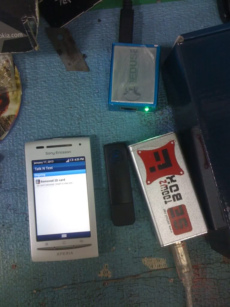

phone pics. ok with signal
