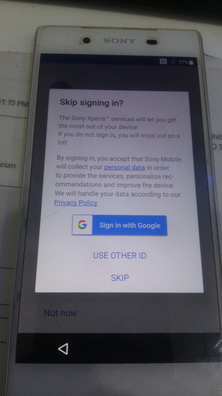

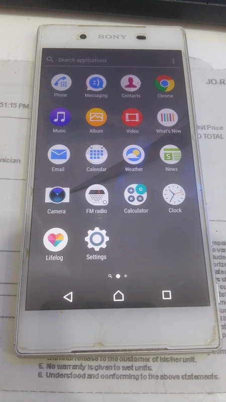

share ko lng mga boss Xperia E6653 FRP lock. Done via Z3x!!!
SS:

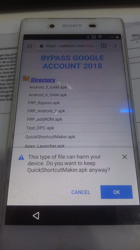

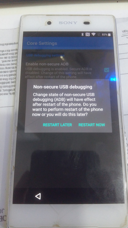

procedure:
1st. enable ADB VIDEO TUT
SS:

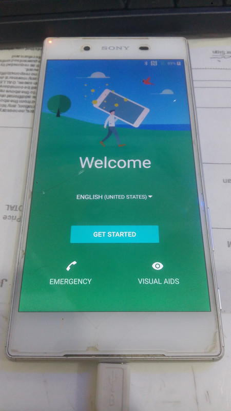

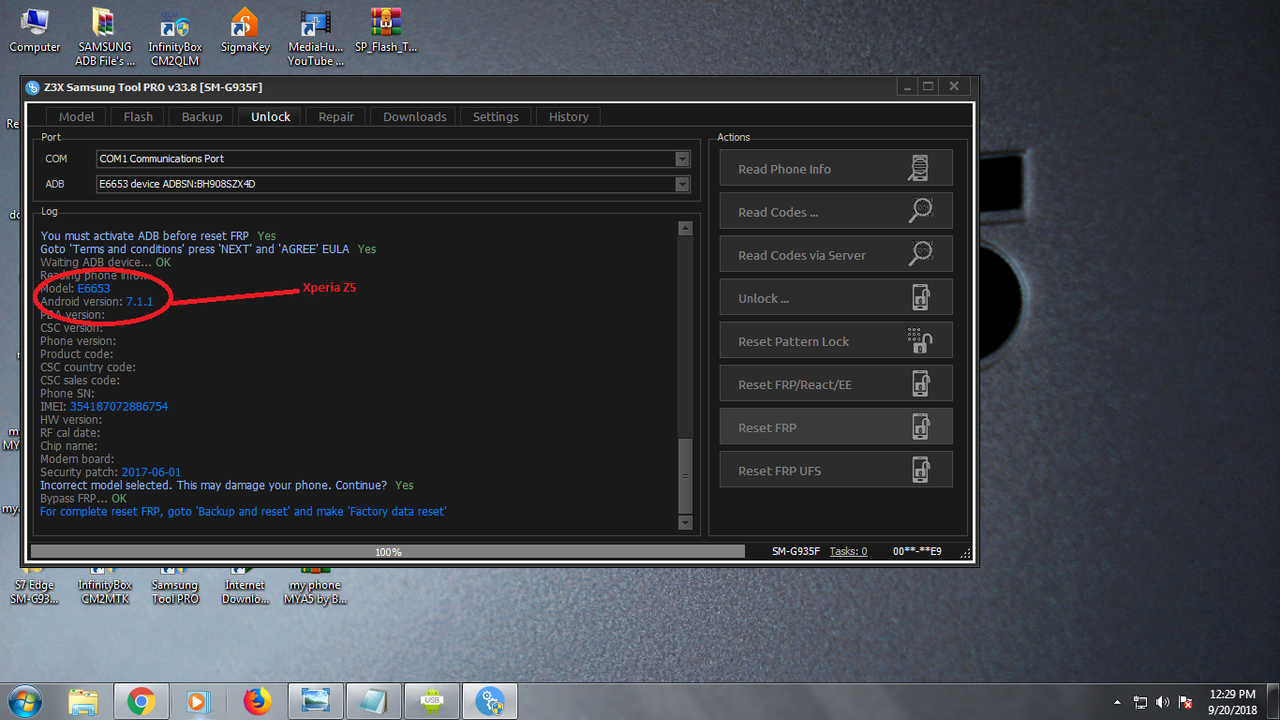

after restart proceed na sa reset frp, gamit ko ay z3x
SS:
image hosting sites

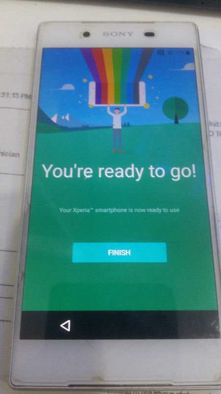

finish product:
"ANTGSM BACOLOD CHAPTER"
SS:
procedure:
SS:
SS:
image hosting sitesfinish product:
