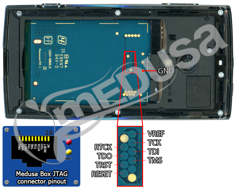

needed:
*medusa jtag box
*jtag wire cable
*sldering iron samahan mo pa ng pang jumper
procedure:
*solder jtag wire to jtag pin-out as shown in the picture
*start medusa softwear (latest version)
*select advance mode
*click connect
*read boot
*unlock
wait until finish
