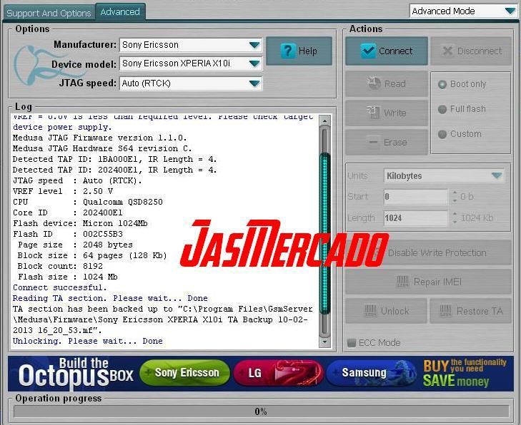

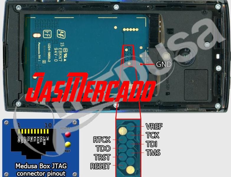

B BLIND Registered Joined Dec 23, 2014 Messages 2,965 May 6, 2015 #1 unit; XPERIA X10i status; network lock tool's; medusa box w/pkey rj45 cable pinout procedure's open medusa soft select sony ericsson select corrrect model(sony ericsson XPERRIA X10i) JTAG pinouts for Sony Ericsson XPERIA X10i tick connect tick unlock wait until finish
