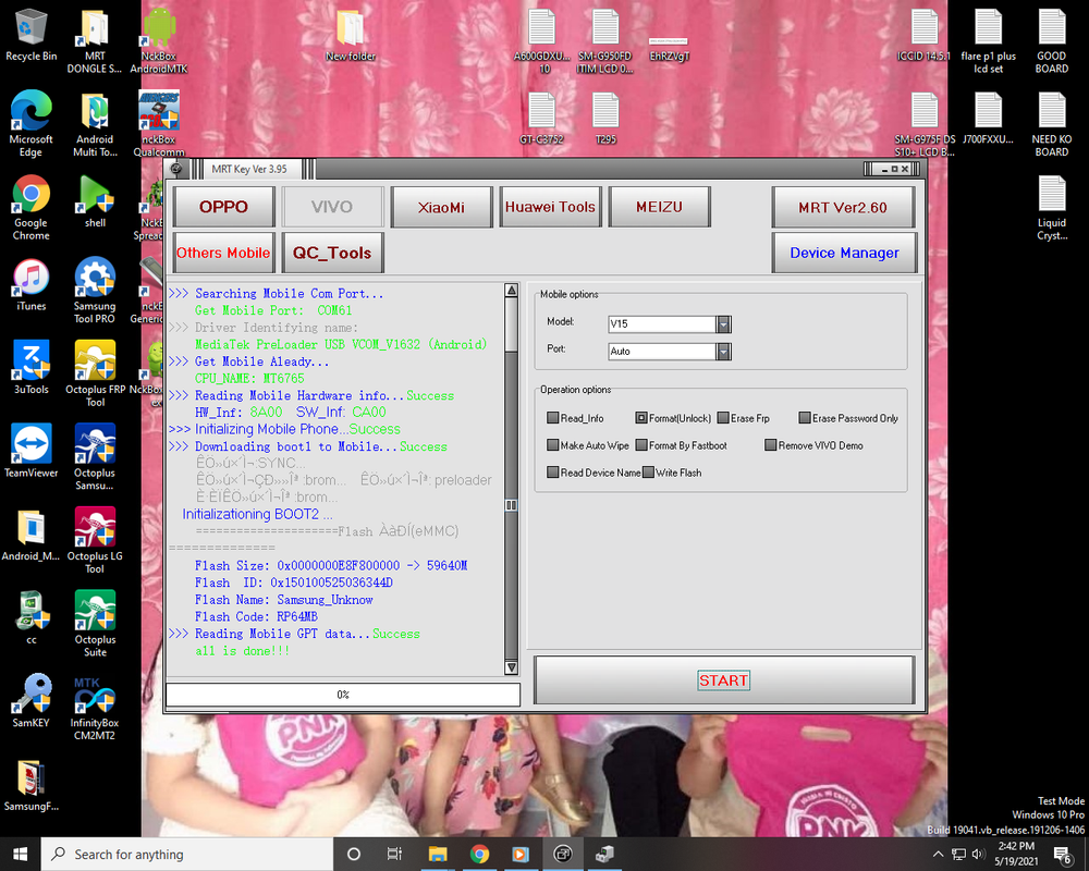

Y11 1906 password
selected model V15 (vivo)
format (unlock)
connect phone in normal mode
start
power off the connected phone
wait a seconds
done
disconnect then power on phone
wait 3-5 minutes after all
setup skip finish
done

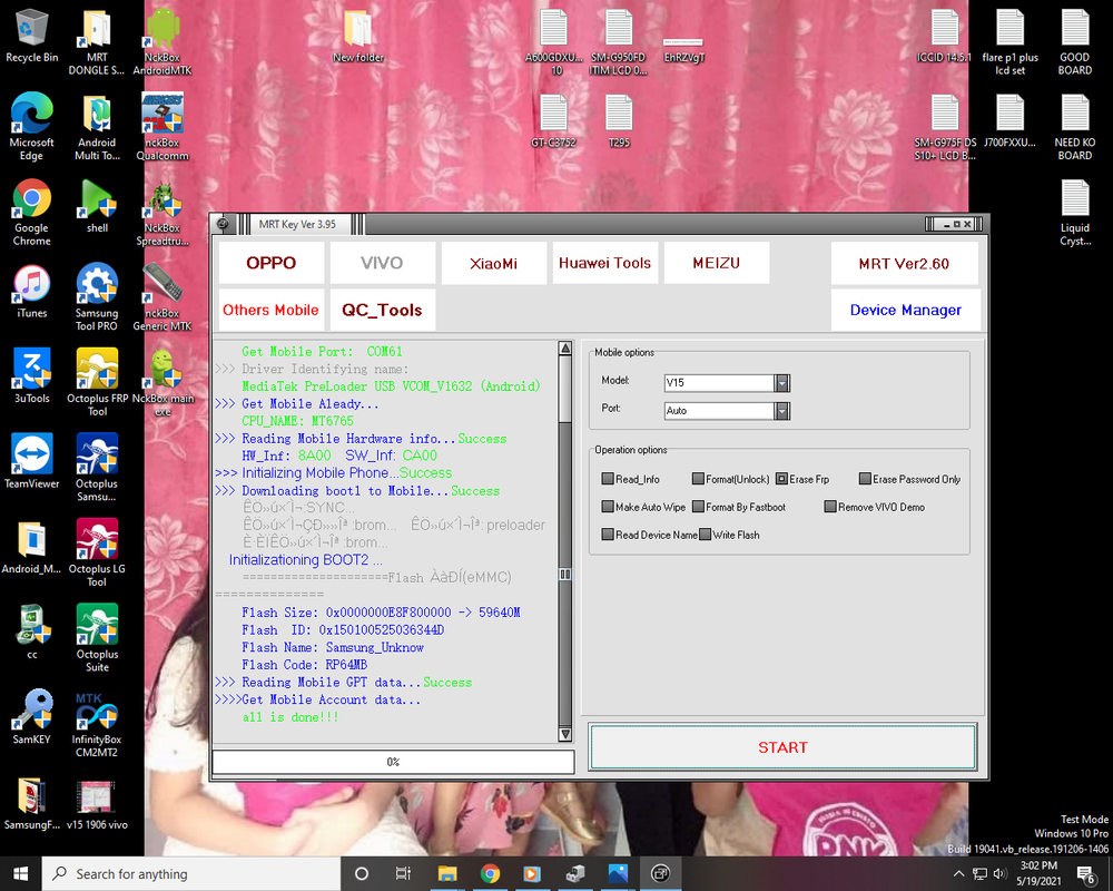

incase theres an frp lock
Y11 1906 password
erase frp

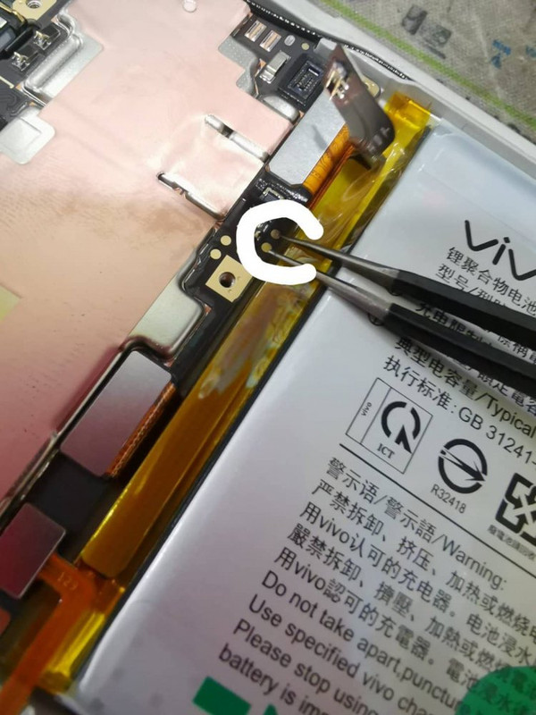

connect testpoint using tweser
start
wait a seconds
done
setup skip finish
done
