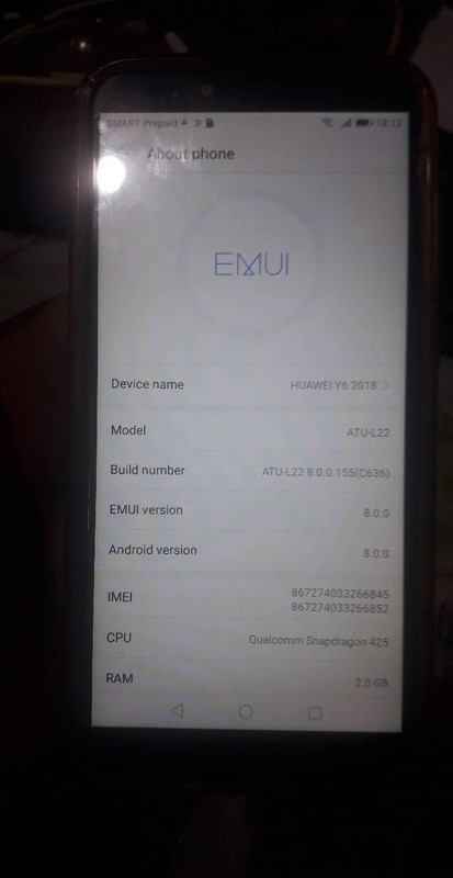

Y8 2018 (ATU-L22) PASSWORD FRP DONE VIA MRT
PROCEDURE

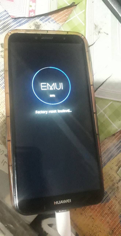

hard reset muna para mawala c password alam nmn na yun di ko na explain
then may frp sya

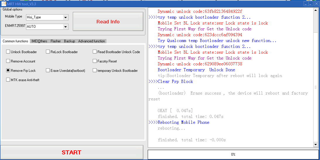

open mrt latest version
tick huawei tool
tick huawei unlock
tick frp remove
turn off phone
put phone in adb mode by using usb cable volume down + power
install driver
then start
wait lang until done
screenshots
after salang sa mrt ganyan sya
wait lang medyo matagal mag open

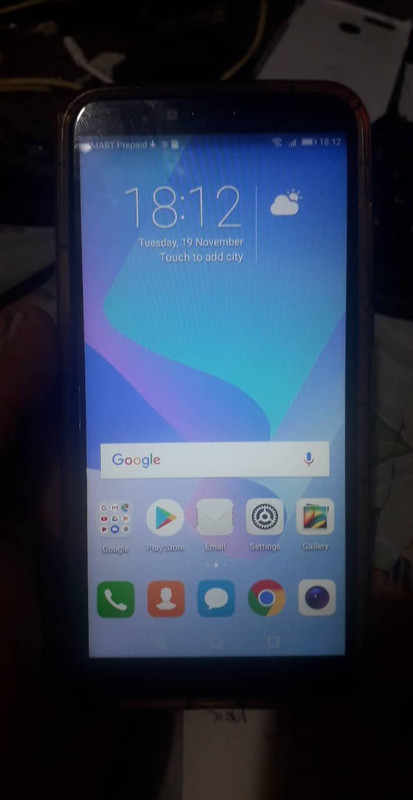

done done
