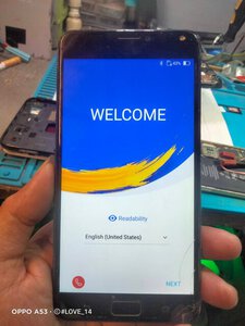

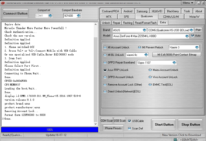

BongKier Registered Joined Jun 15, 2021 Messages 361 Reaction score 246 Points 41 Location NAGPAYONG 2, PINAGBUHATAN PASIG CITY Jul 8, 2022 #1 Open miracle thunder Crack -select qualcom -Extra -brand -model:asus zenfone 4max -Asus frp Unlock -Port(9008Qlcm) Hold Volume Up + Down Buttons -Insert Usb Cable -Start Button And done.. thanks for viewing sa like narin salamat po naway makatulong
