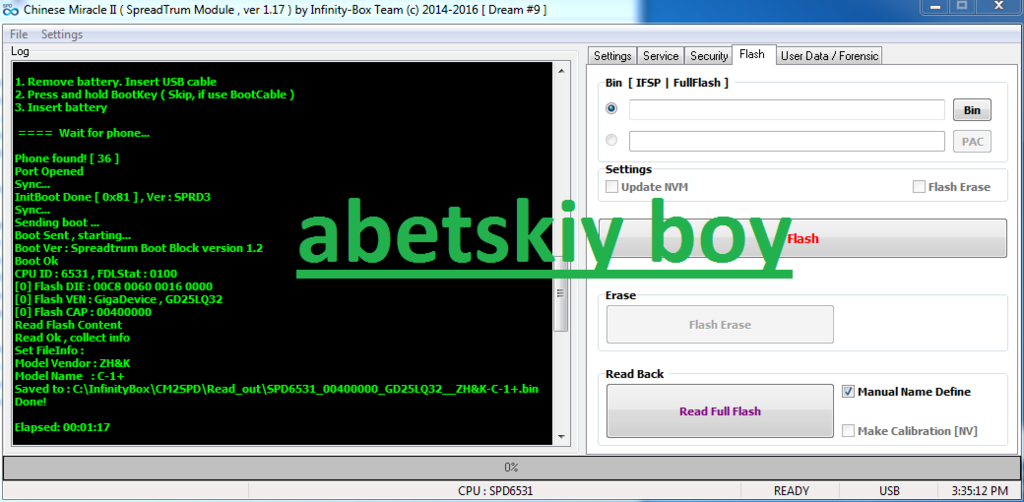

1.CLICK RUN SPDCM2
2.CLICK SITTING & CPU SPD6531
3.CLICK FLASH & READ FULL FLASH

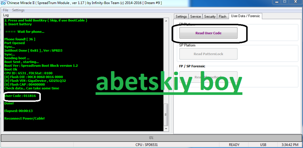

4.CLICK USERDATA/FORENIC & READ USER CODE

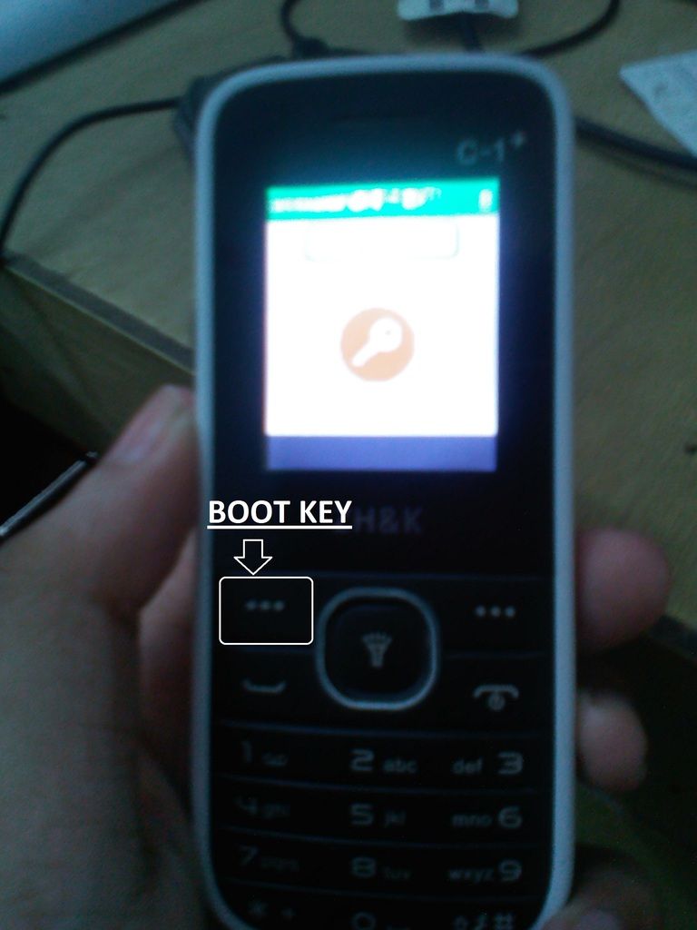

5.CLICK RUN USER CODE OFF PHONE BOOT KEY NASA PIC LANG PO
PAGKATAPOS READ CODER NG PASS TYPE NINYU LANG SA UNIT YUN PASS OK NA PO ANG UNIT
