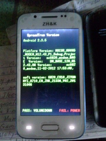

Unit:
ZH&K H710
Problem:
Too many pattern attempts

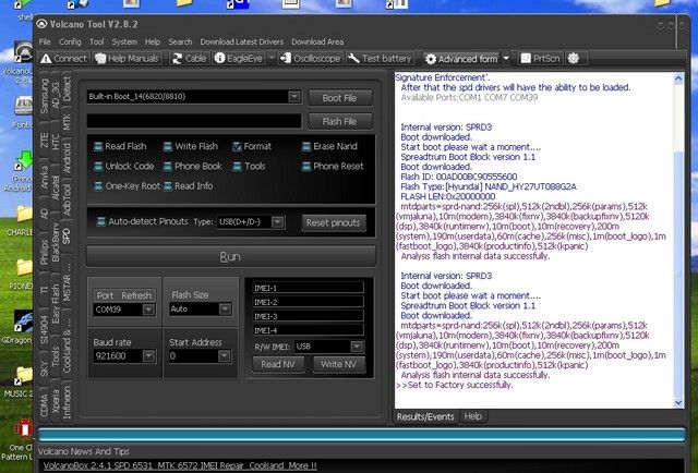

Tools/Gadget:
Volcano
MicroUSB cable
Action taken:
>kapa kapa muna pero ito lang ang napalabas
Mainipin pa costumer.
>Kaya ito na lang Open volcano tool
>SPD
>boot 6820/8810
>uncheck auto detect
>read info
>press vol- (connect phone install driver pag naghanap)
>format
