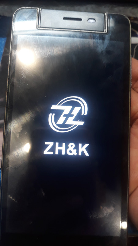

brand: ZH&K
PROBLEM: HANG LOGO
TOOLS: CM2 MTK
hang at 3 months di nagamit sabi ng owner bigla nlang naghang kaya hanap ako dito firmware ito ang gamit ko...http://www.antgsm.com/showthread.php?t=199122&highlight=zh%26k+odyssey+popo
ito hang...

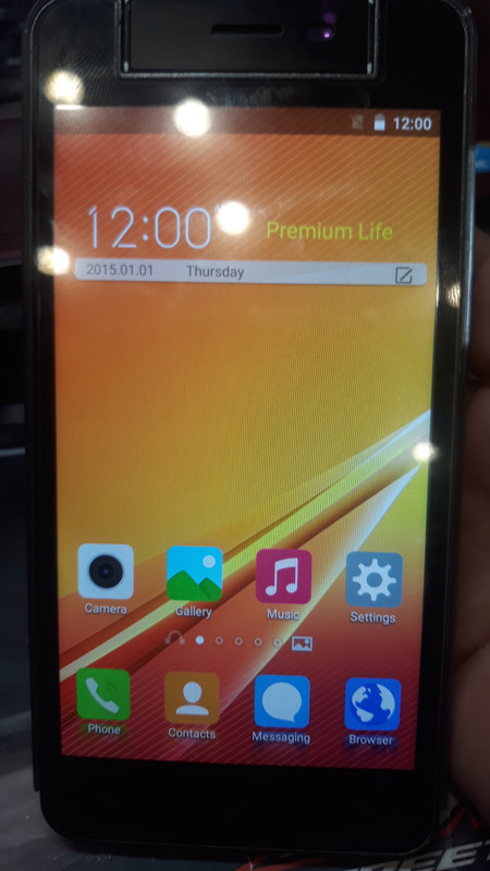

Done!
Elapsed: 00:06:17
Reconnect Power/Cable!
[url=http://postimg.cc/QVqV4wpQ]
[/URL]
THANKS SA PAGSILIP..
