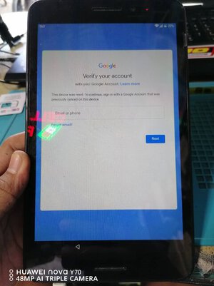

-Procedure
-Turn Off the device
-Press Volume down and Power button to Enter FTM Mode

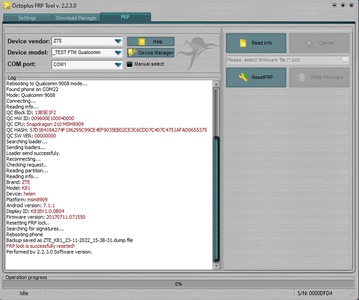

-Open Octoplus Frp Tool select Device vendor (ZTE) Device model (Test FTM Qualcomm)
-Click RESET FRP
-Insert usb cable

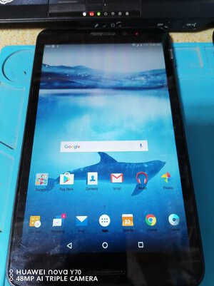

-Wait & Done
