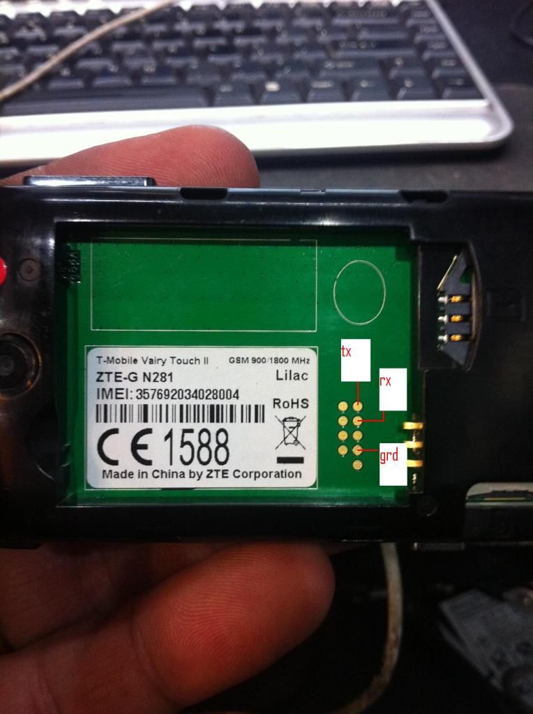

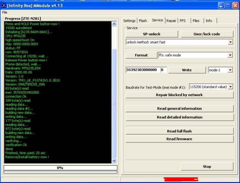

S solenn Registered Joined Sep 19, 2014 Messages 2,423 Dec 14, 2014 #1 zte n281 Tmobile direct unlocked by infinity*** share ko lang po mga idols... Zte n281 locked sa tmobile,direct unlocked by infinity... -open shell -select zte,n281 -run mmodule -connect cable...pls see pic with pinout -smart fast -sp-unlock -done screenshots zte n281 pinout unlocking finish product
