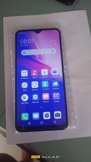

Share ko lang po newbie lang po.
Procedure:

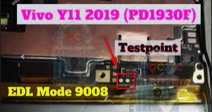

* Open ang phone for EDL test point

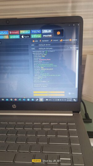

* Open unlocktools , select vivo y11 1906
* Then click EDL Factory Reset , test point and salpak usb cord tas hintay na lang matapos at mag reboot.
pasensya na kulang pic ng procedure.
