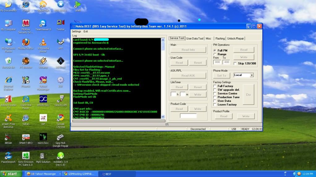

5130xm white screen done...
Unit: 5130xm white screen
Tools:
  • Infinity Best Dongle
  • Usb Cable (CA-101)
Procedure:
  • Open Best GUI
  • tick settings
    • tick connection settings
    • select usb
  • then select flashing tab
  • select model (RM-495)
  • then tick dead mode
  • then tick flash
