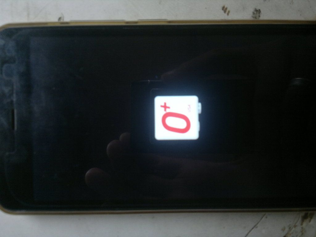

0+ 8.96 hang done reference
history. unfortunately close lhat ng apps. nung nirestart tulala na
hardreset no luck
kaya hanap na firmware
spd pla di naman nabigo. thanks po kay idol gabstech88 . laking tulong thread nia more power boss

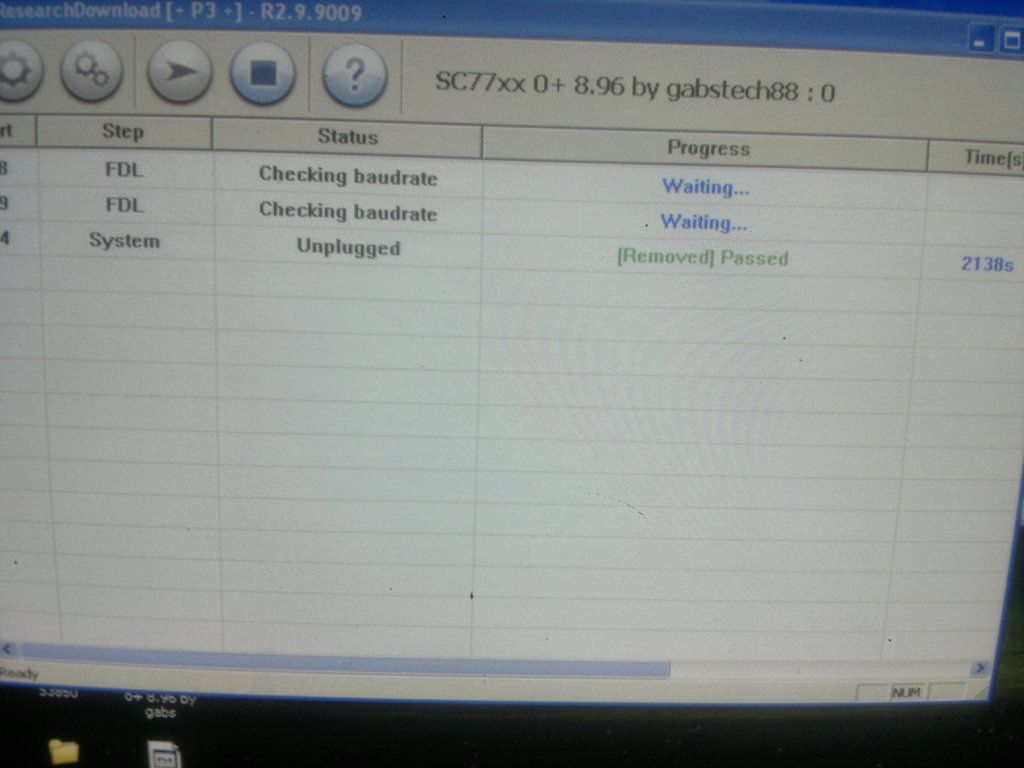

procedure....

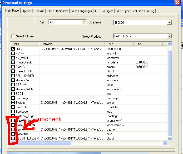

load firmware
click setting
then uncheck nio po yung limang box s baba
then ok
then run start na ..
switch off phone
hold volume + and -
insert usb cable install driver if needed
pag nadetect na wait nio lang mga 2k seconds mdyo matagal

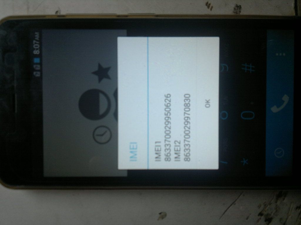

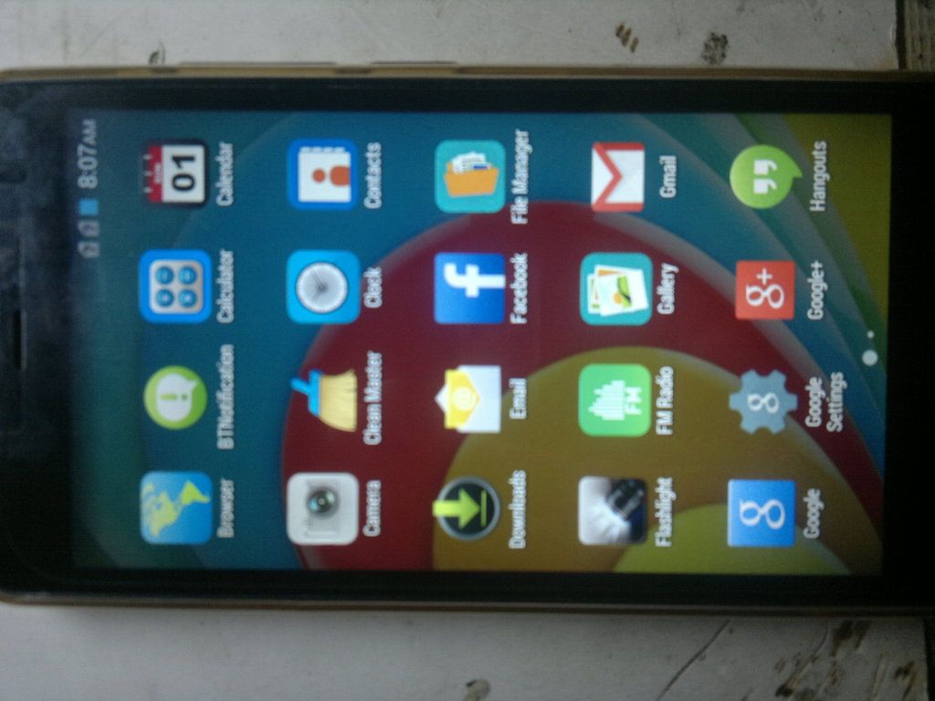

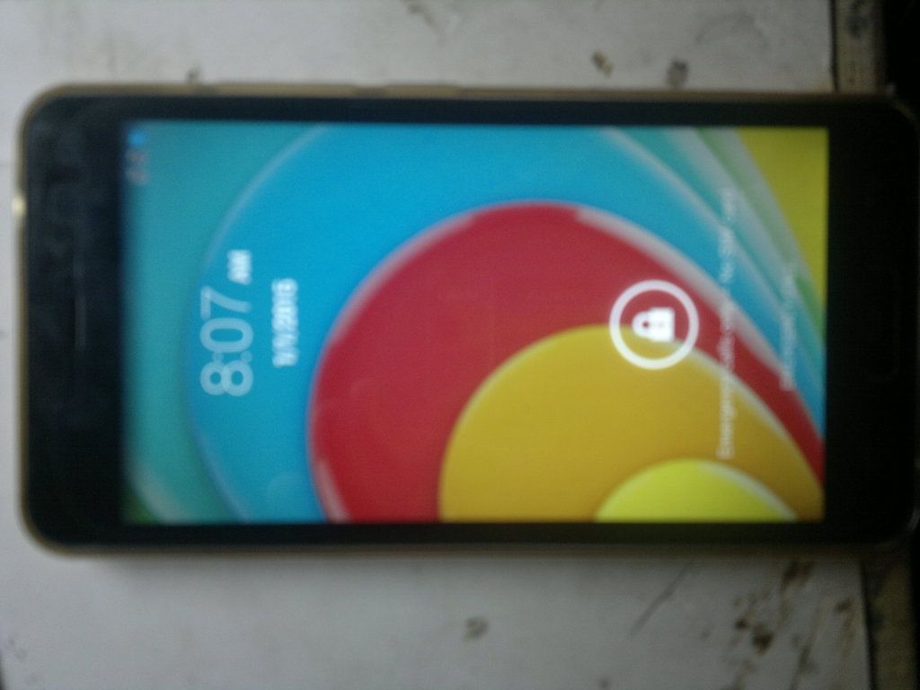

nabuhay na .wala po mabubura
pero para malinis reset nio nlng.kayu n bahala
finish product
malinis n malinis
done for reference thanks

sir na uncheck nio po b yung apat s baba. nassa screenshot po. pag di nauncheck yun patay tlaga.kelangan mo n ng full firmware nyan
