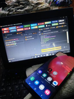

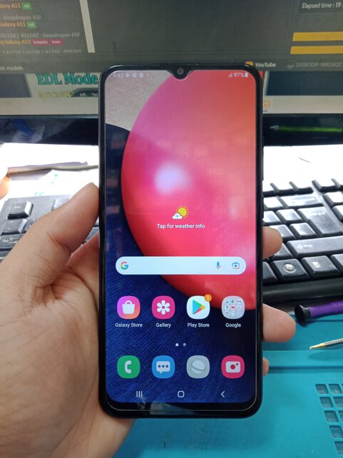

a02s frp problem
procedure

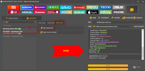

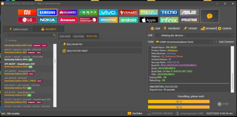

step 1 : open unlock tool select samsung hanapin ang model a02s (a025f/ds)

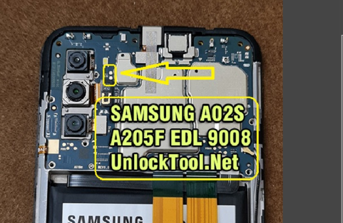

step 2 : pumunta sa BROM I EDL tapos tespoint mo muna then salpak cable bago pindotin erase frp wait mo hanggang matapos
testpoint
