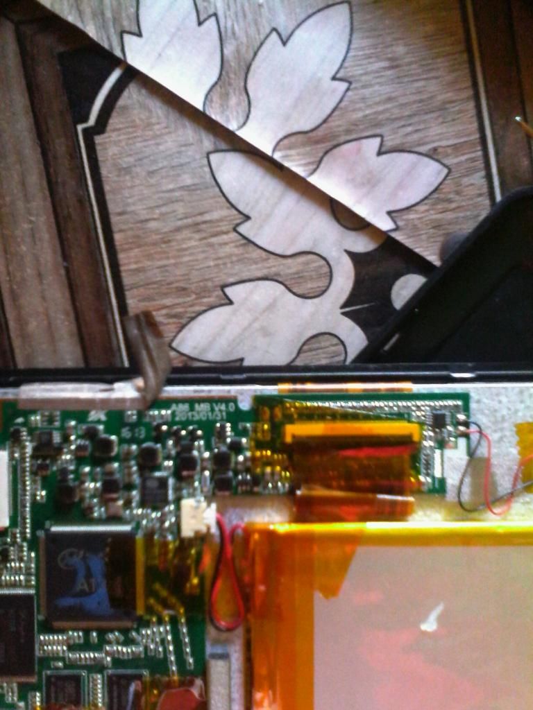

a13 A86 MB v4.0 2013/01/31 TMPA done firmware inside

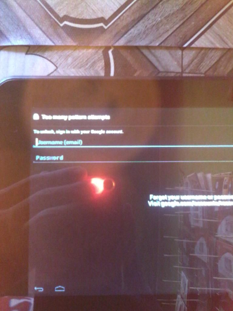

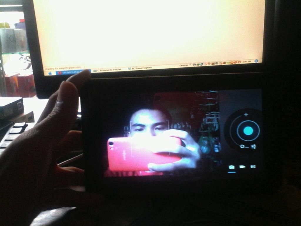

:) good day po satin mga boss share kolng to a13 [A86_MB_v4.0 20130131 pattern lock d mgdeteck sa ibang crack d kc nka usb debug kya hanap ako firmware pra ma flashan.

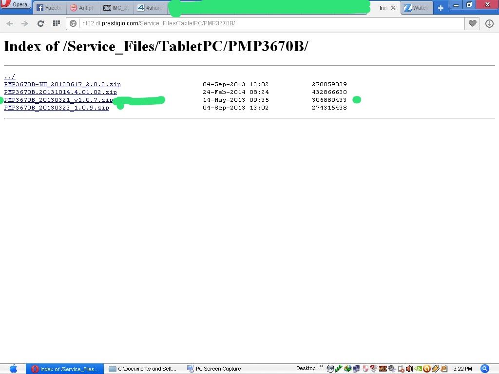

ito po ung firmware mga boss hirap kc to hanapin masyado nkatagu
http://nl02.dl.prestigio.com/Service_Files/TabletPC/PMP3670B/
lalabas po ang 4pcs firmware click lng po itong comapatible an firm [PMP3670B_20130321_v1.0.7.zip ] tulad nung nsa image ko :D

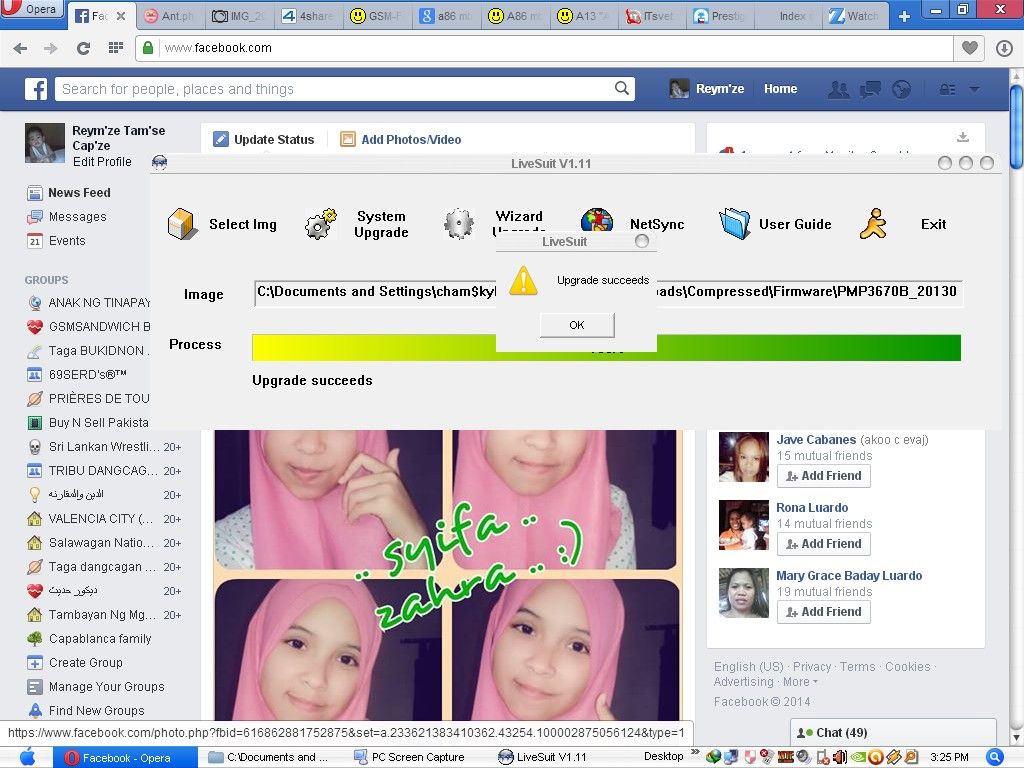

pgkatapos ko am DL try agad
success :)

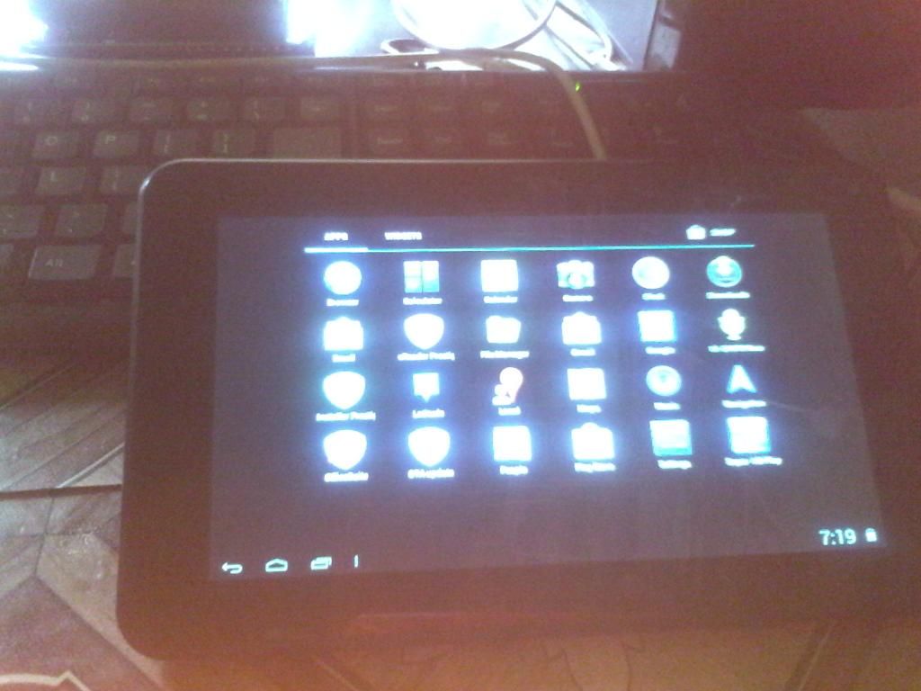

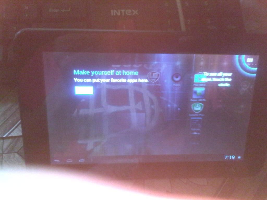

pgkatapos flashan try agad,, :D
ok po laht touch at camera
salamt sa mag view nito :D sana po makatulong ung firmware ko good day mga boss,,pa hit nlng po ng thankz button mga boss salamt ulit
