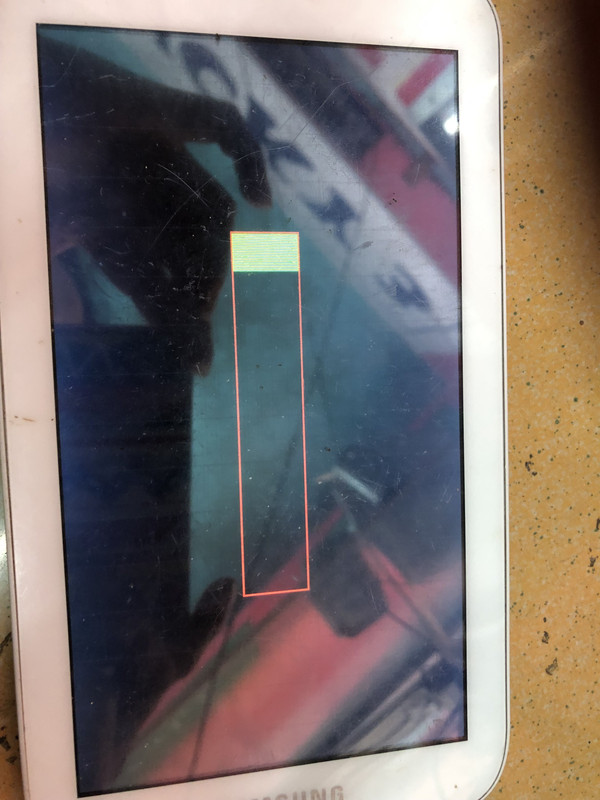

A23 TAB T736 MAINBOARD V2.1 HANG LOGO DONE USING PHOENIX CARD
PROBLEM: HANG LOGO
TOLLS: PHOENIX CARD https://androiddatahost.com/sddw2
FIRMWARE http://gsm-firmware.com/index.php?a=downloads&b=file&c=download&id=11709
GUIDE:

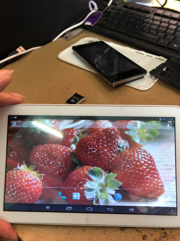

PHOENIX CARD GAMIT KO MY PROB CHRGING PIN BURN LANG PO SA SD UN FIRMWARE USING PHOENIX CARD..OFF TAB INSERT SD N BURN POWER ON UN TAB WAIT MATAPOS REMOVE SD IN TAB THEN ON DONE...
