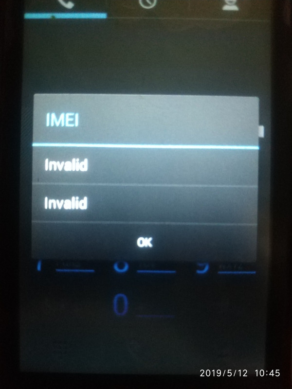

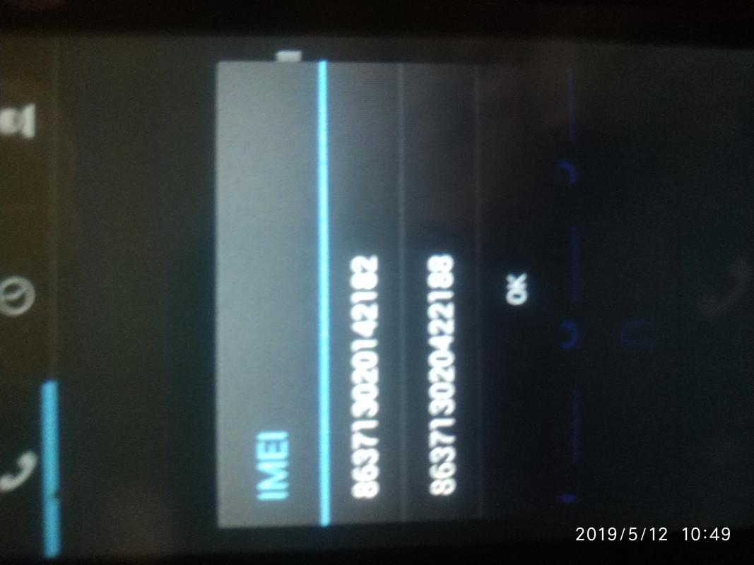

Invalid Imei after Flash

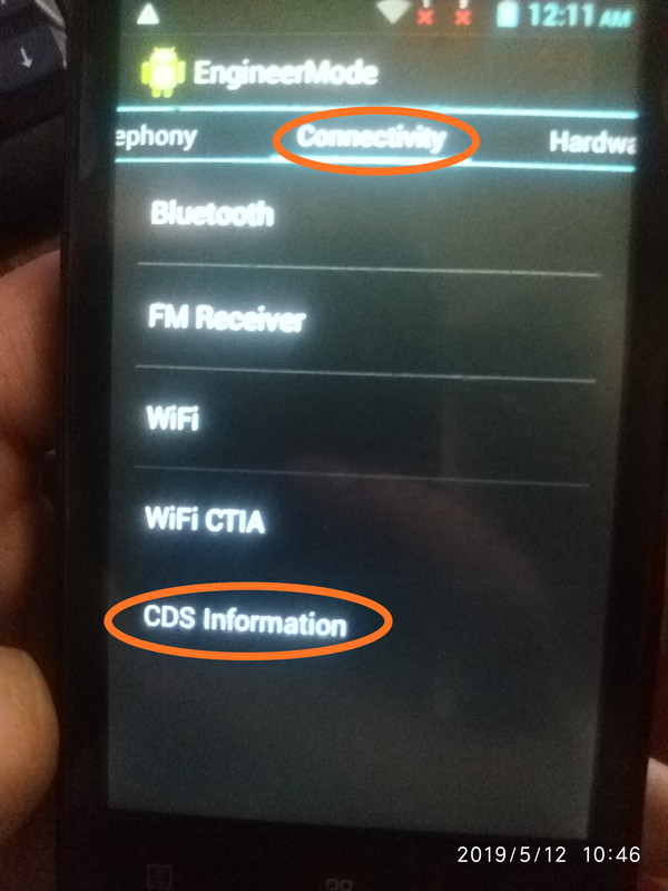

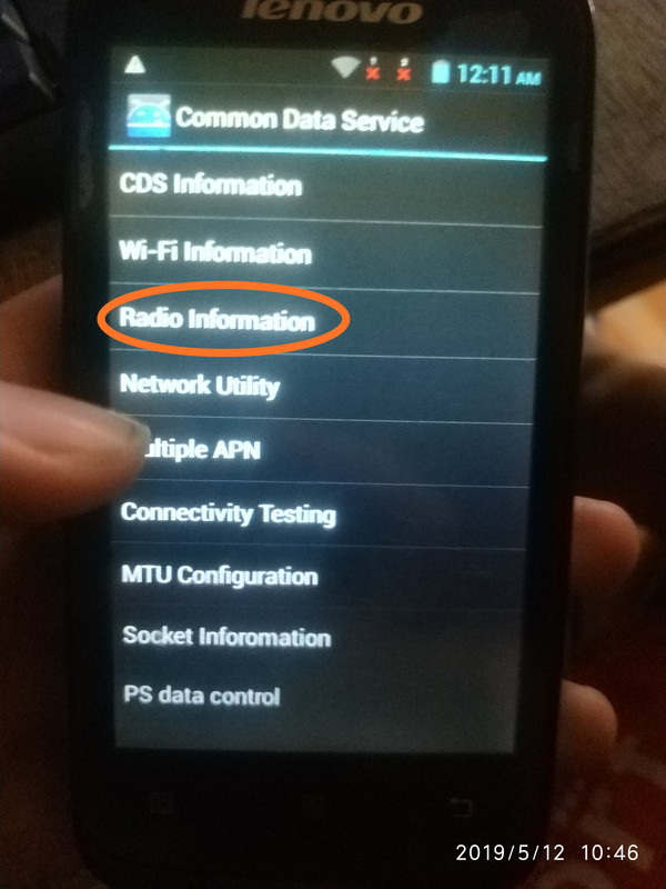

Procedure: ENGINEERING MODE
1. Dial *#*#3646633#*#*
2. Follow the picture below then
3. Select "Phone 1" i set Imei na nakalagay sa likod ng phone at itype,
(AT+EGMR =1,7"IMEI1") hit set command,
dapat may mag nonotif na command successfully sent.
4. phone 2 naman (AT+EGMR =1,10"IMEI2") hit set command.
5. Reboot
Note: may space between EGMR and =
applicable din to sa ibang luma na mediatek sana makatulong sa dipa nakakalam
