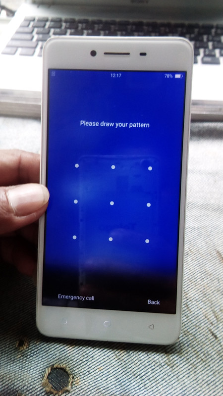

PROBLEM: pattern
nakalimutan ng may ari at may importante naka save sa phone nya daw ayaw pa reformat..

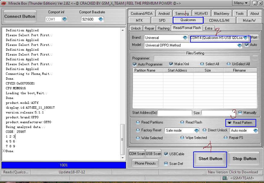

ACTION TAKEN: read pattern kai miracle crack
1. open miracle crack
2. select qualcomm
3. select read/format flash
4.hold volume up and volume down
5.install the driver
click port pag ok na driver
select read pattern and click start button..hintayin lumabas ang pattern....

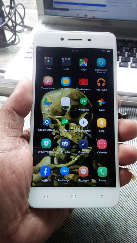

done pera na.......
2. select qualcomm
done pera na.......
