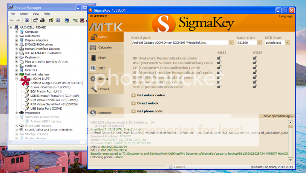

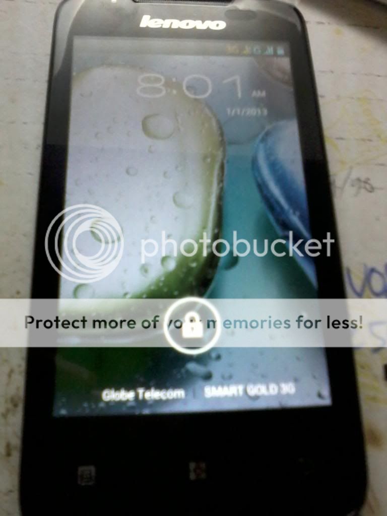

A390 Lenovo locked to smart unlock succesfully!
Procedure:

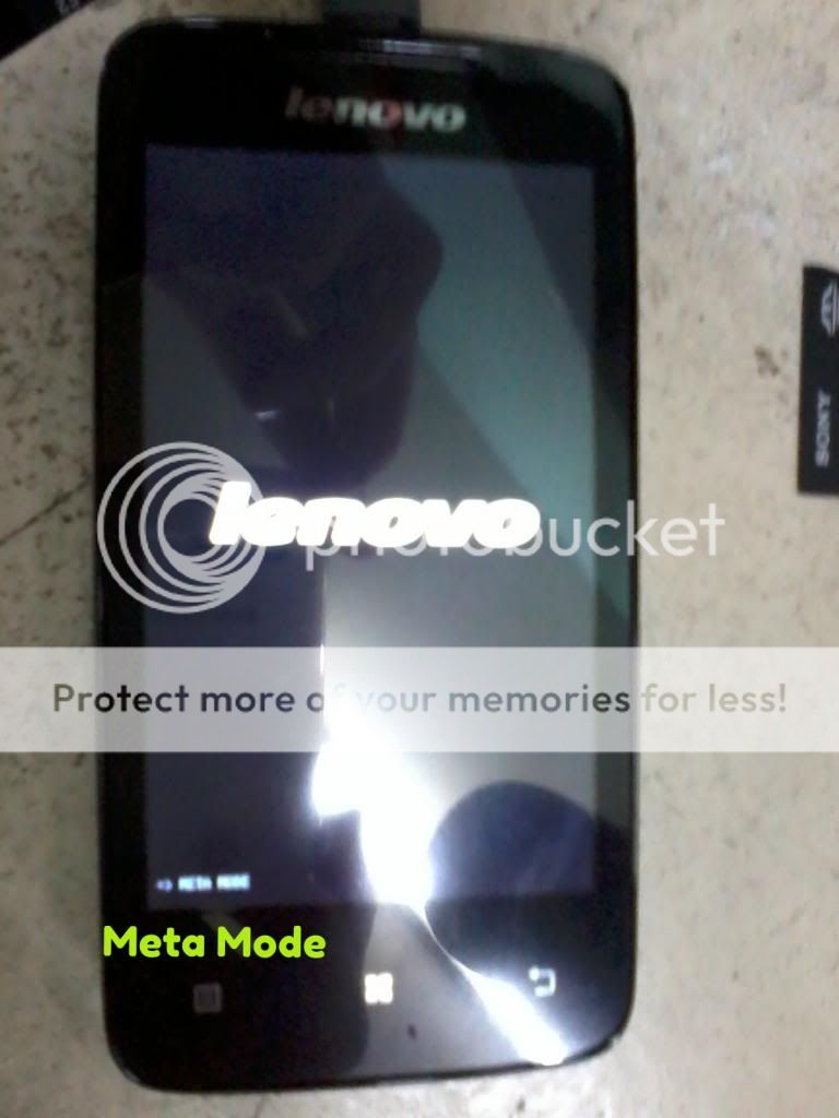

1.Phone must be off
2. insert usb 5310 cable direct from usb hub from p.c
3. install driver and must boot into "META MODE"
4. select proper serial port "Android Gadget VCOM Driver (COMXX) *Mediatek"
5. Press direct unlock
Screenshots:
