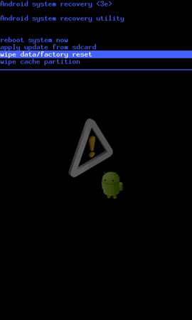

From the Recovery screen, press both volume buttons (NOT SEARCH ICON ON KEYBOARD)
Select wipe data/factory reset.
Note Utilize the Volume keys (up / down) to highlight and the Power button to select.

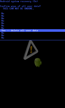

Select Yes -- delete all user data.

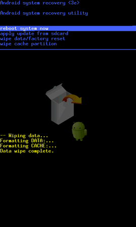

Note Allow the factory reset process to complete (approximately 1 minute).
Select reboot system now.
Note Allow several minutes for the reboot process to complete.
